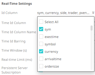

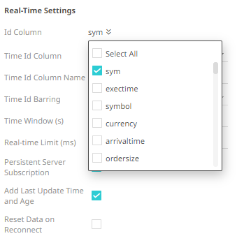

    Consequently, on the Real-Time Settings section,  the Id Column drop-down list displays the set of columns, of arbitrary type.
  2. Select a key column to manage data updates and inserts. In some cases, select multiple key columns to form a unique row identifier.

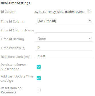

  3. You may opt to select the Add Last Update Time and Age checkbox.
    NOTE: This option is enabled when No Time ID has been selected.
    This allows the latest update time and its age to be highlighted by the defined color range in the output dashboard. Refer to Highlighting the Latest Data in Real Time Streaming Connectors for more information.

  5. Define or select the following information:
    • Time Id Column Name for Automatic Time Id
    • Time Id Barring
      Select the barring period. This conflates the data set to a defined granularity or any of the following time intervals.
    • Time Window (s). The default is 0.
  6. Modify the Real-time Limit to vary the data throttling. This defaults to 1000 milliseconds.
    NOTE: The Real-time Limit can be parameterized.
  7. Select the Persistent Server Subscription checkbox. This means that it will not be purged.
    If not selected,  Panopticon Real Time can purge or cancel the subscription if it is orphan and is running out of memory. Note though that it can be purged for other reasons as well, depending on how the user has set it up.
  8. Select the Reset Data on Reconnect checkbox to flush out the stale data and reload data after reconnection.
