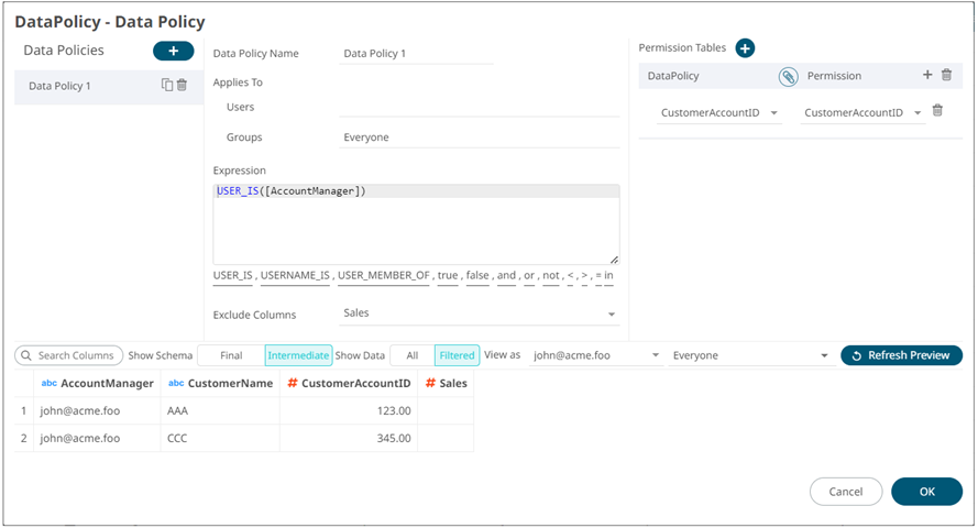

Special Functions for Data Policy Access Rules
Panopticon supports the following macros, and their parameters, for data policy access rules definition.
Function Description Example
USER_IS(username)
Validates the user identity by comparing the lowercase user name, stripped of domain,
with a static string or column value.
USER_IS(“john.doe”)
USER_IS([UserNameColumn])
USERNAME_IS(username)
Validates the user identity by comparing the unmodified user name, including the domain, with a static string or column value.
USERNAME_IS(“John.Doe@acme.org”)
USERNAME_IS(“Acme\John.Doe”)
USERNAME_IS([UserNameColumn])
USER_MEMBER_OF(group)
Validates user group membership by checking the user groups of the logged in user for the existence of a static string, or column value.
USER_MEMBER_OF(“SalesTeam”)
USER_MEMBER_OF([AccountRegion])
Here are data policy access rule examples:
USER_IS([AccountManager])
USER_MEMBER_OF("Managers")
USER_MEMBER_OF("Managers") AND USER_MEMBER_OF("IndiaTeam")
USER_IS([AccountManager]) OR USER_MEMBER_OF("SalesLead")
