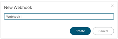

  1. On the Webhooks tab, click on a folder then  .
    The New Webhook dialog displays.
  2. Enter the name of the webhook then click  .
    The new webhook is displayed on the Webhook page.
