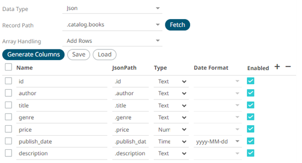

- The connector tries auto discovery of the Data Type (JSON, Text, XML, Excel, HTML, Arrow IPC)
When loading JSON data, the Record Path can be suggested automatically by pressing the Fetch button. Refer to the section Supported JSON Structures for details about the available options for turning the JSON into a table structure.

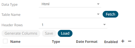

For the Web Data connector, you can also select the HTML data type.
Property Description Table Name
Click
to fetch HTML table elements then select the HTML table.Header Rows
Select the number of rows in the table to be retrieved as column headings. The default value is 1, but a higher number should be set if the HTML table has column titles that use more than 1 row. If all rows of the table are data and there are no column headers, set it to 0.
NOTE: If no table element is found in the HTML document, an error message displays.

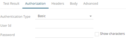

Authentication Type Description None
No authentication needed.
Basic
Enter the User ID and Password to connect to the connector’s service.
Select the Show Characters box to display the entered characters.

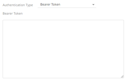

Bearer Token
If you already have a authentication token, enter the token string into Bearer Token input box. This can be parameterized also.

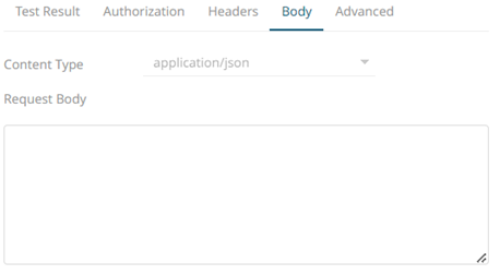

- Set the Body if a POST/PUT request is required.
- Select the Body tab.
- Set the required settings:
Property Description Content Type
Select or enter content-type based on request body (payload) format.
NOTE: This property is disabled when the HTTP Method is GET.
Request Body
The Request Body for the HTTP POST method.

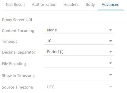

- Select the Advanced tab.
Property Description Proxy Server URI
The HTTP Proxy setting will allow the connector to reach the endpoint.
Content Encoding
Select the Content Encoding with the HTTP Header: None, GZip, Deflate, or GZip and Deflate.
Timeout
The length of time to wait for the server response (10 to 300). Default is 10.
Decimal Separator
Select either the dot (.) or comma (,) as the decimal separator.
File Encoding
Set the character encoding to use in text data.
- UTF-8
- UTF-16
- UTF-16BE
- UTF-16LE
- US-ASCII
- Windows-1252
