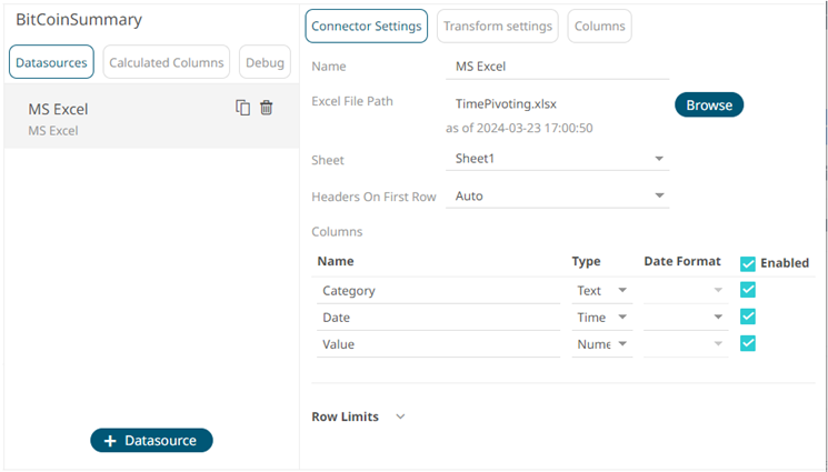

  1. Upload a data source snapshot by clicking  and browse to the file source.
    When a file is selected, the MS Excel connector will automatically select the first available sheet, set the first row as headers, and populate available columns.
    By default, all the generated columns are enabled. You can unselect the Select All checkbox, then select the checkboxes of the columns that will be enabled.
  2. Adjust Sheet selection, if required. Selecting a new sheet will re-populate the Columns list.
  3. Adjust the Headers on First Row if needed. By default, the connector will pick up headers from the first row if all cells on the first row contain text data.
    You can select one of the following:
    • Leave headers on first row as Auto if you want the connector to automatically pick up column names from sheet.
    • Select Yes to force picking first row as headers.
    •  Select No to force not picking first row as headers. This will auto generate all column names.
  4. Adjust column Type or Date Format to adjust data interpretation.
