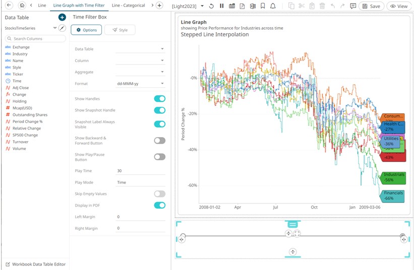

  1. After double-clicking or drawing a rectangle on the dashboard canvas, select Time Filter Box     on the Select Part pane.
    The Time Filter Box Settings pane is displayed, and the Time Filter Box part is added on the dashboard canvas.
  2. Select a Data Table from the drop-down list then select the time series filter Column.

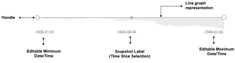

    The Time Filter Box now displays:
    • Editable Minimum Date/Time
    • Editable Maximum Date/Time
    • Handles for quick filtering of the time period
    • Time Slice Selection (Snapshot Time)
    • Line Graph representation of the time series column

  4. The Format field lets you specify the format that Date/Time will be displayed in.
  5. Proceed to setting the time filter box settings:
    Setting Description
    Show Handles
    Determines whether handles are displayed. Enabled by default.
    Show Snapshot Handle
    Determines whether to display the snapshot handle. Enabled by default.
    Snapshot Label Always Visible
    Determines whether to always display the snapshot label. Enabled by default.
    Show Backward & Forward Button
    Determines whether the Backward and Forward buttons are displayed to move through time slices.
    Show Play/Pause Button
    Determines whether the Play   or Pause   button is displayed and adds the ability to automatically play through all the time slices.
    It subsequently automatically moves through each time slice until it reaches the end of the time window, causing the playback to reset.
    Play Time
    How long the play time will run if the Pay Mode is Ticks. Default is 30.
    Play Mode
    Determines whether the play mode is either Time or Ticks.
    Setting to Time will playback the time slices as quickly as possible.
    Setting to Ticks will playback a time slice based on the set Play Time.
    For example, there are 8 time slices in the Time Series visualization, setting the Play Time to 16 will playback a time slice per 2 seconds (i.e., will move the snapshot one step per 2 seconds).
    Skip Empty Values
    Determines whether to skip empty values.
    Display in PDF
    Determines whether to include the time filter box in the PDF output.
    Left Margin
    The margin area on the left side of the time filter box.
    Right Margin
    The margin area on the right side of the time filter box.
  6. Click the Save   icon on the toolbar to save the changes.
