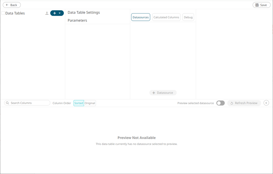

- On the Data Table pane, click
The Workbook Internal Data Table Editor view displays.
- On the Data Tables pane, click
and select New Data Table:
A new data table instance is created.

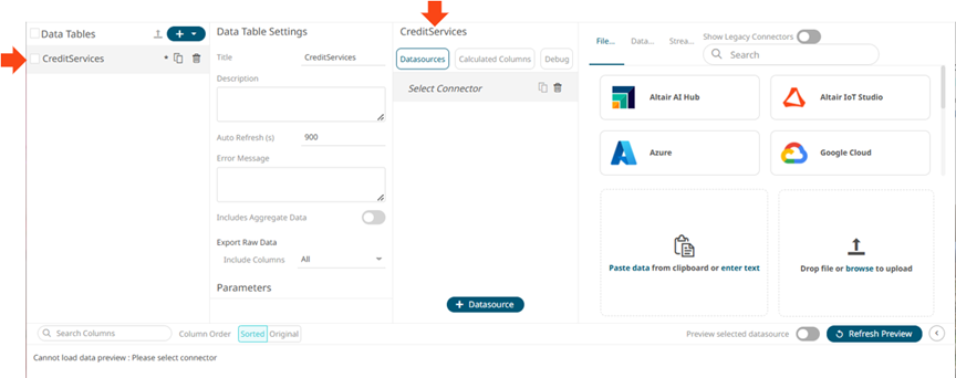

- On the Data Table Settings pane, enter the Title of the data table and click
. The new name is applied to the data table under the Data Tables pane and on the Data Sources pane.
- Enter the Description of the data table.
This is also displayed under the data table instance which can be helpful when selecting among the data tables in the list.

- To add a data source, click a connector group tab.
- File/URL
Then select one of these data sources:
Tap the Show Legacy Connectors slider to turn it on and display the following legacy connectors you can select:
- Database
Tap the Show Legacy Connectors slider to turn it on and display the following legacy connector you can select:
- Streaming
- File/URL

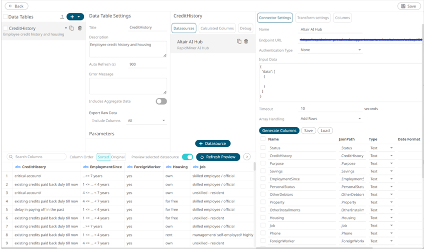

- Tap the Preview Selected Data Source slider to turn it on and display the preview of the selected data source.
- Then, you can either click:
for static connectors
for streaming connectors
The retrieved query/table/sheet/schema is displayed in the Data Sources pane. The system displays preview data at the bottom of the screen.
Click
to collapse the Data Preview pane.
Click
to expand the Data Preview pane. - After adding data sources, you can also:

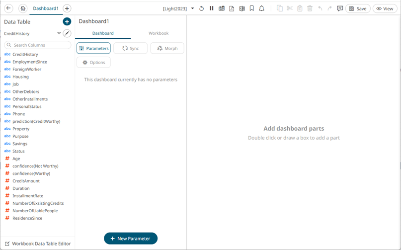

- Click
. You are returned to the Open Workbook in Design Mode, with the new data table added in the Data Table pane drop-down list.
