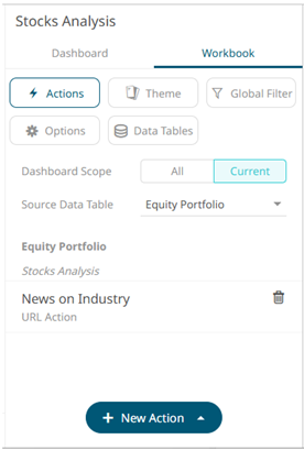

  4. Click the   button then select URL Action in the drop-down list.

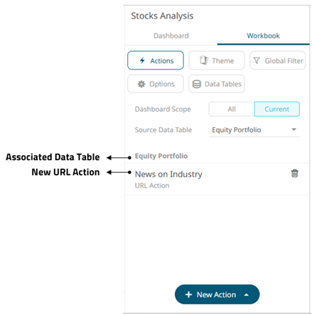

    The new URL action is added under the selected Dashboard Scope in the Actions list. For example, if Current is the selected dashboard scope and the source data table is Equity Portfolio, then it will be displayed as:

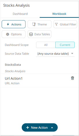

    However, if no source data table is selected, then the first one in the Data Table pane (i.e., StocksData) is the default associated with the new URL action.

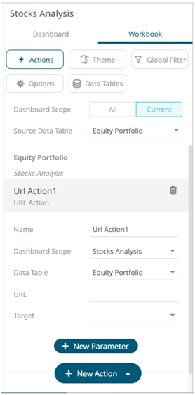

  5. Click the new URL action instance to expand and display the properties that you can define.
  6. Enter or select the following properties:

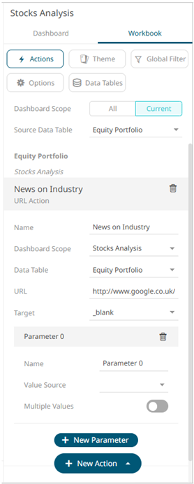

  7. Click the   button to add parameters to the output URL. A new parameter instance is added.
  8. Click on the parameter instance to expand and define its properties.

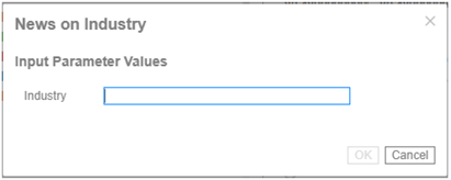

    When an action is executed which require an interactive parameter, an associated dialog box will be displayed.
    For example:
