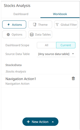

- Select the Dashboard Scope where you will define the dashboard scope data parameters that will be passed to the target dashboard: All or Current.
- Select the Source Data Table from the drop-down list.
- Click the
button then select Navigation Action in the drop-down list.

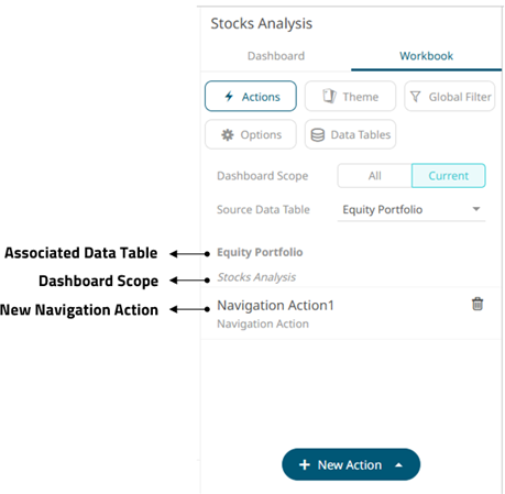

The new navigation action is added under the selected Dashboard Scope in the Actions list. For example, if Current is the selected dashboard scope and the source data table is Equity Portfolio, then it will be displayed as:
However, if no source data table is selected, then the first one in the Data Table pane (i.e., StocksData) is the default associated with the new navigation action.

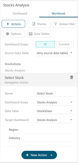

- Click the new navigation action instance to expand and display the properties that you can define.
- Enter or select the following properties:
Setting Description Name
The name of the navigation action and then click
.Dashboard Scope
The dashboard where you will define the dashboard scope data parameters that will be passed to the target dashboard.
Can either be [All Dashboard] or the current dashboard.
Data Table
The source data table. This will eventually be displayed above the navigation action instance.
Target Dashboard
The dashboard where you want to pass the parameters to.

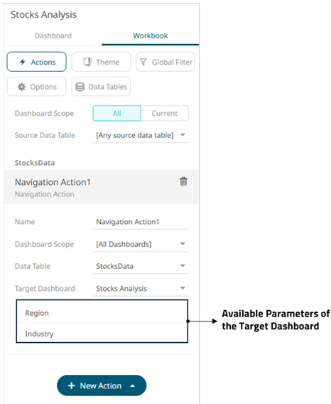

Parameters Name
The available parameters of the selected target dashboard.

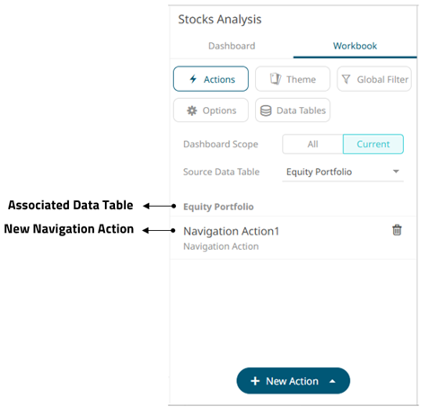

Clicking the All Dashboard Scope, a new navigation action is available.
If the Dashboard Scope is [All Dashboard], the new navigation action will be displayed as:
