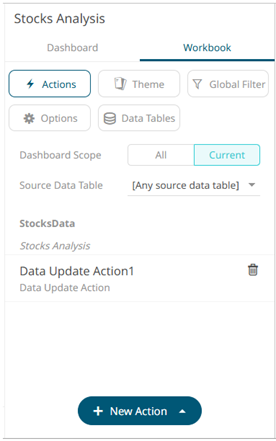

    The Actions pane is displayed. Initially, there are no actions defined for the workbook and the selected Dashboard Scope is All.
  2. Select the Dashboard Scope where you will define the dashboard scope data parameters that will be passed to the target dashboard: All or Current.
  3. Select the Source Data Table from the drop-down list.
  4. Click the   button then select Data Update Action in the drop-down list.

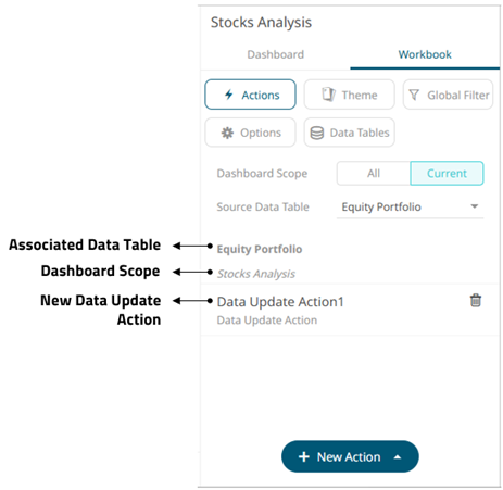

    The new data update action is added under the selected Dashboard Scope in the Actions list. For example, if Current is the selected dashboard scope and the source data table is Equity Portfolio, then it will be displayed as:
    However, if no source data table is selected, then the first one in the Data Table pane (i.e., StocksData) is the default associated with the new navigation action.

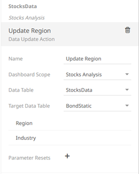

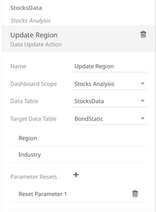

  5. Click the new data update action instance to expand and display the properties that you can define.
  6. Enter or select the following properties:
    Setting Description
    Name
    The name of the data update action and then click  .
    Dashboard Scope
    The dashboard where you will define the dashboard scope data parameters that will be passed to the target dashboard.
    Can either be [All Dashboard] or the current  dashboard.
    Data Table
    The source data table. This will eventually be displayed above the navigation action instance.

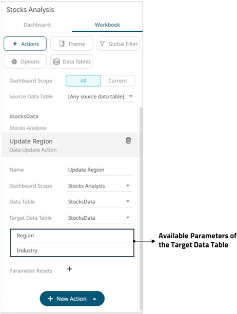

    Target Data Table
    The data table where the parameter value will be passed.
    The defined parameters of the selected target data table will be displayed in the Parameters section.
    Click on the parameter instance to expand and define its properties.

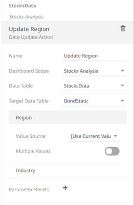

    For each parameter added, set or select the following properties:
    Setting Description
    Value Source
    Select the column value from the source table that will supply the contextual value.
    If you select [Use Current Value], the current parameter value will be passed to the dashboard.
    Multiple Values
    This passes multiple values for the parameter to the target area. Tap the slider to turn it on. The Value Separator field displays.
    Specify the value separator to be used.

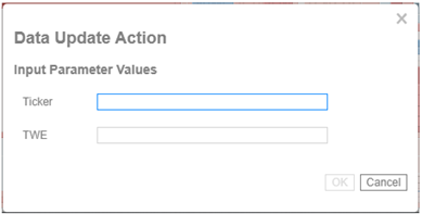

    Input Validation and Error Message
    Both fields are enabled when an interactive parameter (i.e., $Interactive)  is selected in the Value Source drop-down list.
    Typically, interactive parameters are used to pass data back to data repositories or external systems.
    When an action is executed which require an interactive parameter, an associated dialog box will be displayed.
    For example:
    Add a custom Input Validation. This can be any regular expression (e.g., “A-Z{3}”)
    The parameter will not be updated unless it passes the validation. Enter an Error Message to help in defining a better input to match the regular expression (e.g., “Please use a 3-letter code.”)

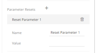

  7.   You can also opt to specify one or several existing parameters that will get a new value when the Data Update Action is executed. You can do so by clicking   on the Parameter Resets section.
    A new Reset Parameter instance is added.
  8. Click on the parameter instance to expand and define its properties.
  9. For each reset parameter added, set the following properties:
    Setting Description
    Name
    Any existing parameter that will get a new value when the Data Update Action is executed.
    Value
    A static value or a reference of another parameter.

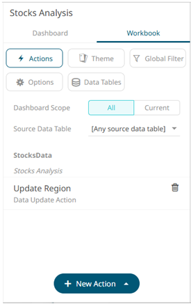

  10. Click the Save   icon on the toolbar to save the changes.

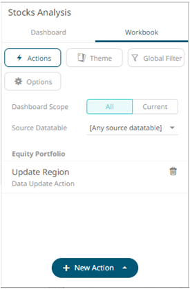

    Clicking the All Dashboard Scope, the new data update action is available.
    If the Dashboard Scope is [All Dashboard], the new data update action will be displayed as:
