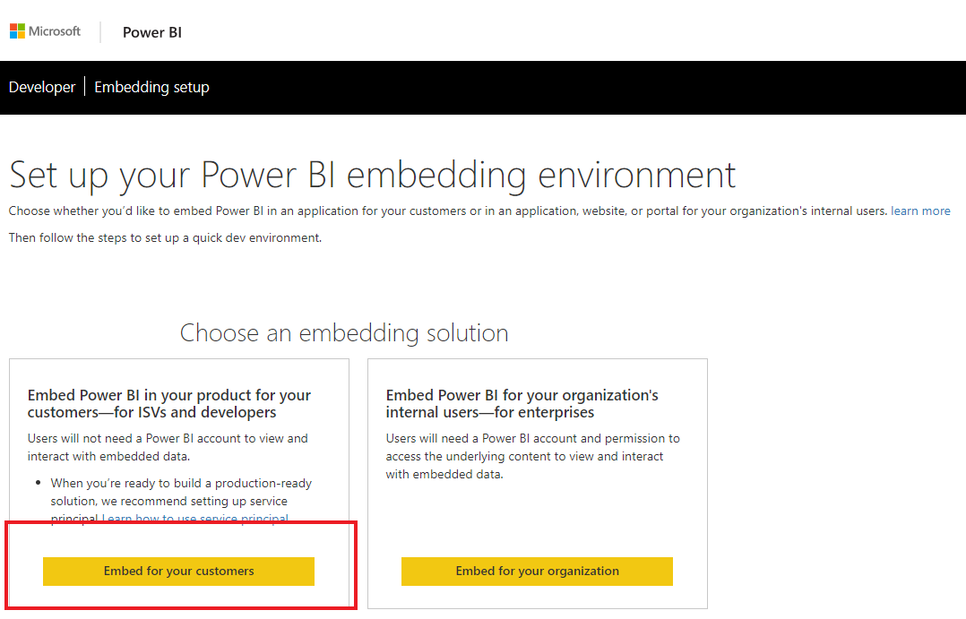

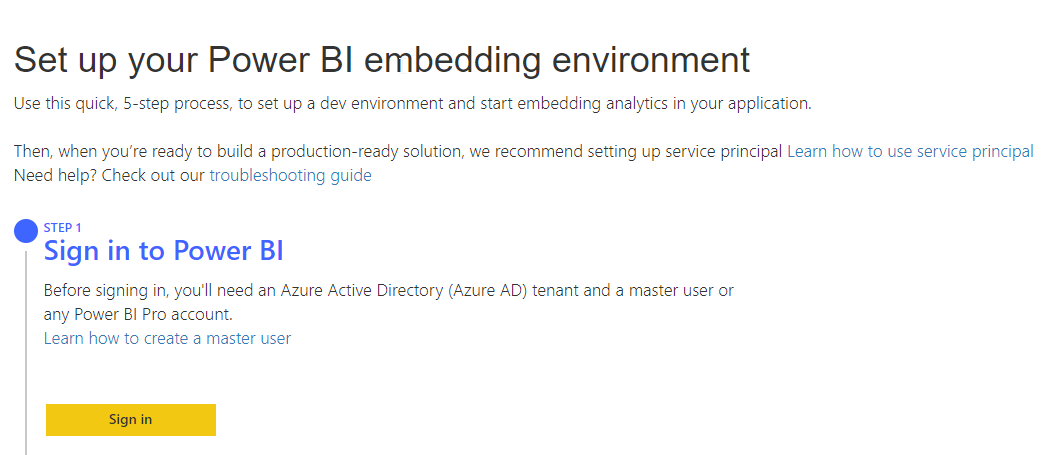

To register the Automator application using the Power BI Embedding Tool
  1. Access https://app.powerbi.com/embedsetup. From the choices of embedding solution, select Embed for your customers.
NOTE: The registration process in Power BI requires an Azure Active directory, an organizational user, and a Power BI service account. To sign up for an Azure subscription or to log in using an account with such subscription, click here.
To learn how set up your Azure Active Directory and organizational user, click here.
  1. Sign in using your Power BI account in Step 1 of the  Embedding Setup tool, and then click Next.

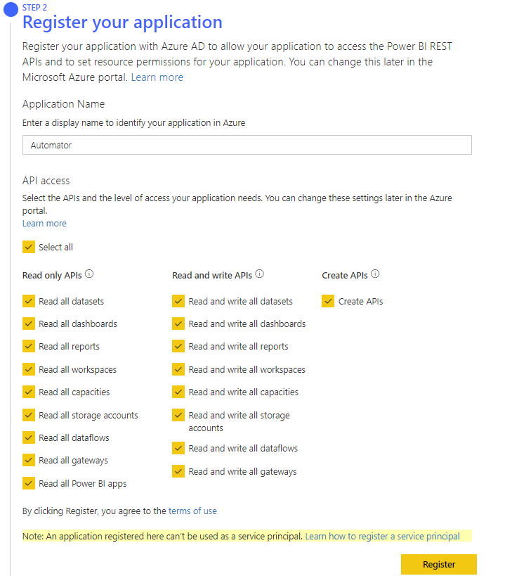

  1. In Step 2: Register your application, provide the following details:
    1. Application Name – The name of your app, i.e., Automator.
    2. API access – Select the APIs you need as well as the level of access required. For details about permissions in Power BI, click here.
Click Register. You may opt to skip Steps 3 and 4 of the Embedding Setup tool at this point.

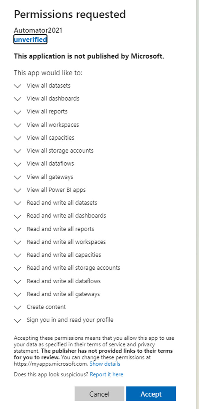

  1. In Step 5 of the Embedding Setup tool, click Grant permissions. This shows the permissions requested for the application.
  2. Click Accept.

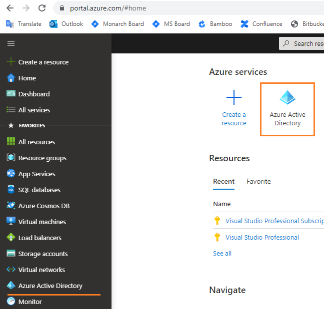

  1. Open the Azure Portal at https://portal.azure.com.
  2. In the list of Azure Services, click Azure Active Directory.

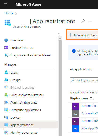

  1. Navigate to App registrations and click the New Registration button. Proceed with the registration of your application.

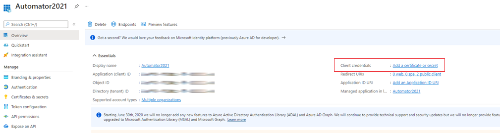

  1. Access Microsoft Azure to view your app registrations by clicking here.
  2. In the Owned applications tab, click the display name of your registered app (e.g., Automator2021) to view its properties, including the Application ID generated previously.

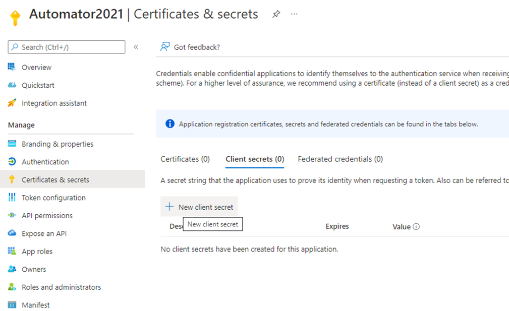

  1. In the Overview pane of the app page, click Add a certificate or secret.
  1. In the Certificates & secrets pane, open the Client secrets tab and create a new secret key by clicking +New client secret.
  1. In Add a client secret, provide a description for the secret key, and set its expiration.
The Client secrets tab should now show the newly created client secret. The text combination under the Value column serves as the client secret key.
