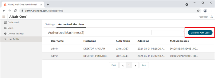

  1. Launch your browser and then go to the Altair One Admin Portal at https://admin.altairone.com. Log in with your credentials.
  2. Once logged in to the portal, navigate to User Profile > Authorized Machines.

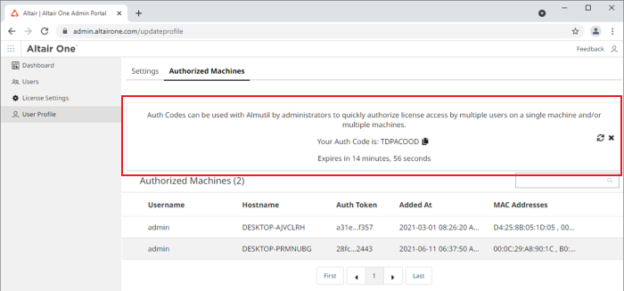

  1. Click Generate Auth Code.
The page refreshes to display the authorization code and a countdown of time left for authorization.

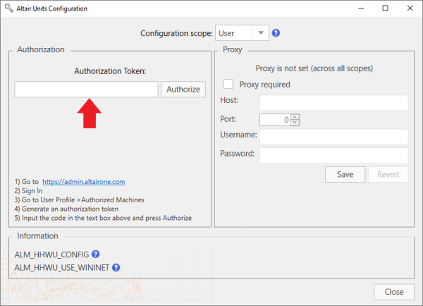

  1. In the Altair Monarch License Manager, ensure that the Managed Licensing tab is selected in the Altair Units License Configuration screen and then click the Configure button .
  2. In the Altair Units Configuration screen that displays, enter the Authorization Code you received in Step 3 into the field provided and then click Authorize.

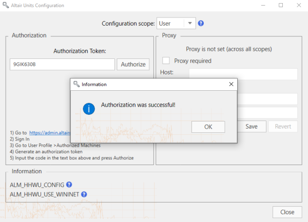

If your machine is properly authorized, the following message displays.
  1. Click OK and then close the screen when you are finished.

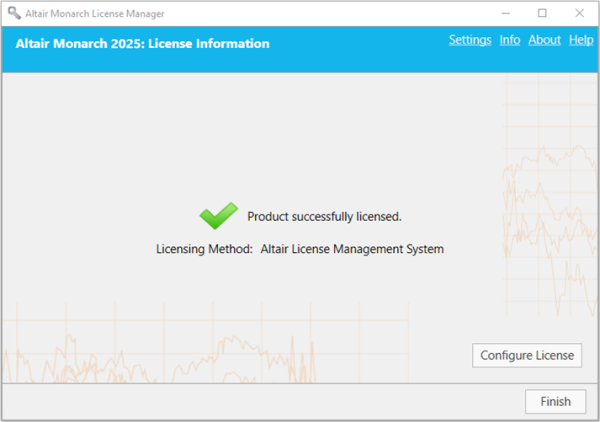

  1. Click Connect in the Altair License Server Connection screen.
Monarch is successfully activated.
