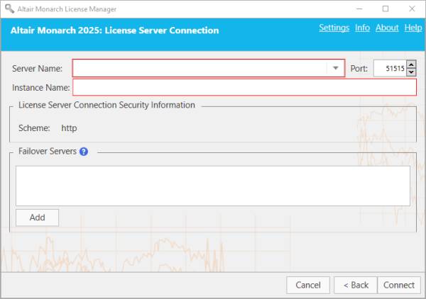

  1. From the Choose License Method screen of the License Manager, ensure that the Connect to a Monarch License Server button is selected and then click Next.
    The License Server Connection screen displays.
  2. Enter the name of the License Server you wish to connect to in the Server Name field. Ensure that your port is correctly specified.

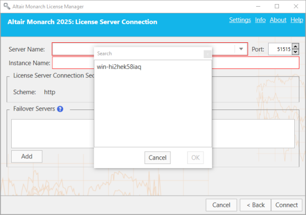

    If you are unfamiliar with the name of the server to which you should connect, select the button located to the right of the Server Name field and then click Browse for all to launch a dialog that lists all available servers in your network. Select the server name you wish to connect to and then click OK.
  3. Specify the instance name of the server to which you wish to connect.
  4. Click Connect when you are done.

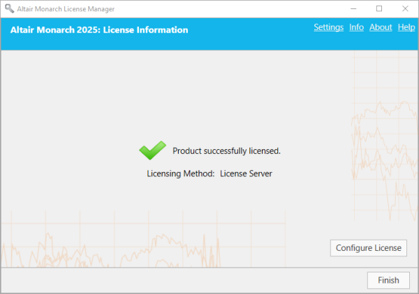

Upon successful connection, the following screen displays.
  1. Select Finish when you are done.
    You can choose to change the license method for your Monarch install by selecting the Configure License button. Doing so returns you to the Choose License Method screen.
    You may now run and use Monarch.

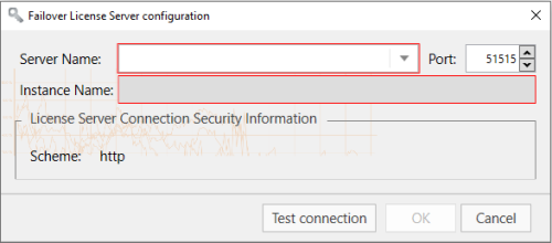

  1. After completing Steps 1 and 2 above, go to the Failover Servers section of the wizard and then click Add.
  2. In the Failover License Server Configuration dialog that displays, provide the information of the license server you intend to use as a failover server.
    Similar to Step 2 above, you must provide:
    • Name of the license server you wish to use as a failover server
    • You can enter the server name manually or browse for it using the button. Clicking the Browse for all item that displays will open a Search window that will show all available servers in your network. The instance name is automatically defined as the instance name specified for the main server.
    • Port number of the License Server service. Here, Port 51515 is defined as the default License Server port but this value can be altered to a custom port.
  3. Test the connection if you wish by clicking the Test Connection button.
  4. Click OK on the Failover License Server Configuration dialog to save the details of your failback server.
