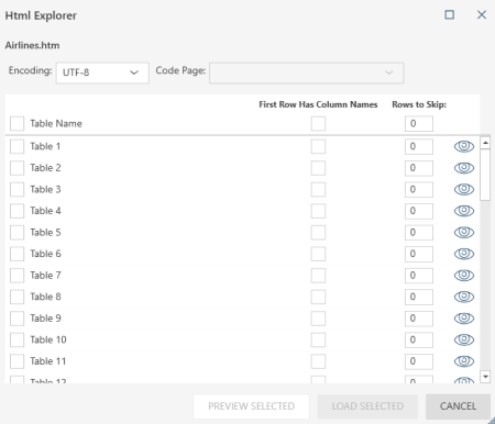

HTML Data Sources
Field
First Row Has Column Names
When selected, indicates that the first row of the sheet includes the column names.
Lines to skip
Specifies the number of rows to skip, starting from the first line, if these lines do not contain data.

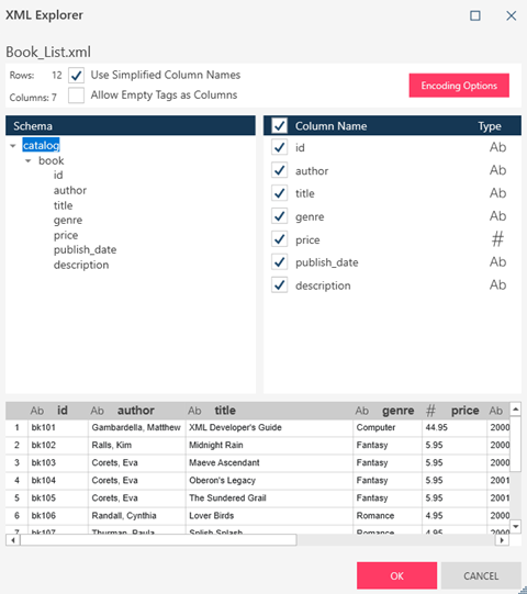

For XML Data Sources
Field
Use Simplified Columns Names
When selected, instructs the application to open the XML table using simplified column names as column headers.
Allow Empty Tags as Columns
When selected, this setting instructs the application to allow the import of XML elements with no values as columns.
This setting applies for both self-closing (e.g., <Name/>) and conventionally tagged (e.g., <Name></Name>) elements.
Encoding Options
Specifies the encoding type to apply when loading the table into your workspace. The encoding types enabled for XML files include:
  • Code Page (with additional options for the required codepage)
  • UTF-8
  • UTF-16LE
  • UTF-16BE

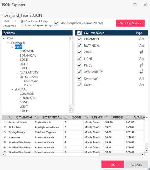

For JSON Data Sources
Field
Row Expand Arrays When selected, instructs the application to transform an array of objects, where each object represents a row with potentially nested arrays, into a more normalized table structure where each element within those nested arrays becomes its own row.
Column Expand Arrays When selected, instructs the application to transform an array of objects, where each object represents a row with potentially nested arrays, into a more table structure where each element within those nested arrays becomes its own column.
When selected, instructs the application to open the JSON table using simplified column names as column headers.
Encoding Options
Specifies the encoding type to apply when loading the table into your workspace. The encoding types enabled for JSON files include:
  • UTF-8
  • UTF-16LE
  • UTF-16BE
