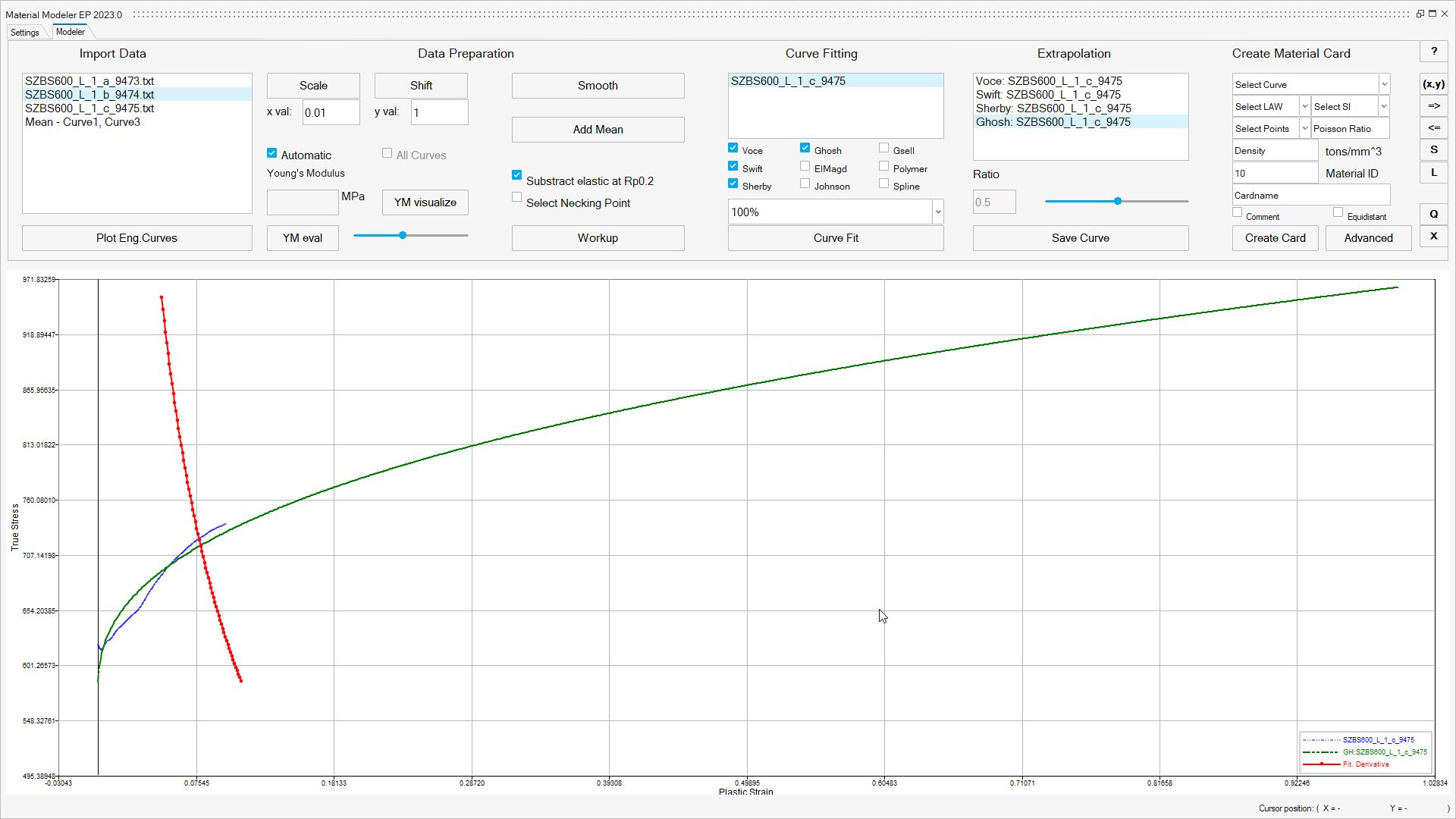

The initial curve (blue). The dashed red curve defines the necking point (begin of material instability), and the green curve represents the resultant curve.
Figure 1. Extrapolation
Extrapolation
Raw data curve (blue); fitted and extrapolated curve (green) and its first derivative (red). The intersection between the blue and red curves indicates the necking point.
