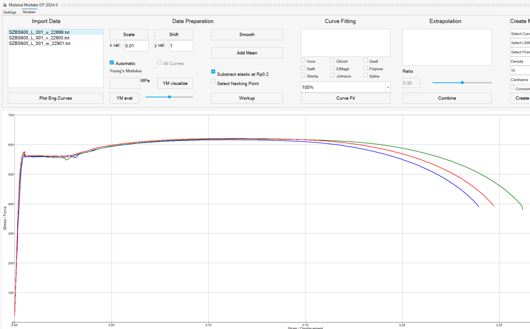

  2. In the Define column and starting row dialog box, specify the start poistion of the measurement data from the data file.
    Note: The Column Displacement defines the engineering strain and Column Force defines the engineering stress.
    The imported files are displayed in the list box.
    Figure 1. Import Raw Data Files
  3. Specify the start position of the measurement data from the data file. Enter the initial column and row numbers as shown and then click OK.
    Figure 2. Column Displacement
    Column Displacement
    The imported files are displayed in the list box and the curves are plotted in the main graphics area.
    Figure 3. Engineering Curves for the Imported Data
