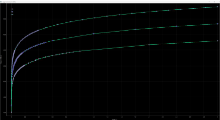

Extrapolation till 100%
  • 60_100% >> 0 till 0.05 Points 21, 0.06 till 0.3 Points 25, 0.35 till 1 Points 14
  • 80_100% >> 0 till 0.15 Points 61, 0.175 till 0.5 Points 14, 0.6 till 1 Points 5
  • 101_100% >> 0 till 0.05 Points 51, 0.06 till 0.5 Points 45, 0.6 till 1 Points 5
    Figure 1. Approximation 100%

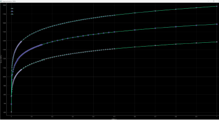

Extrapolation till 200%
  • 60_200% >> 0 till 0.19 Points 41, 0.2 till 0.9 Points 15, 1 till 2 Points 4
  • 80_200% >> 0 till 0.15 Points 61, 0.175 till 0.5 Points 14, 0.75 till 2 Points 5
  • 101_200% >> 0 till 0.05 Points 51, 0.06 till 0.4 Points 35, 0,5 till 2 Points 15
    Figure 2. Approximation 200%
Extrapolation till 300%
  • 60_300% >> 0 till 0.19 Points 41, 0.2 till 0.9 Points 15, 1 till 3 Points 3
  • 80_300% >> 0 till 0.16 Points 61, 0.175 till 0.5 Points 14, 0.6 till 3 Points 5
  • 101_300% >> 0 till 0.05 Points 51, 0.06 till 0.4 Points 35, 0.5 till 3 Points 15
    Figure 3. Approximation 300%
Difference with and without equidistant resolution x-axis values. Example for 100% but it is equal for 200% and 300%.
Figure 4. Equidistant Resolution
