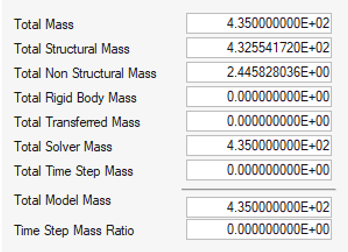

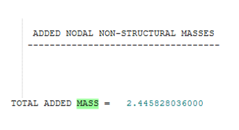

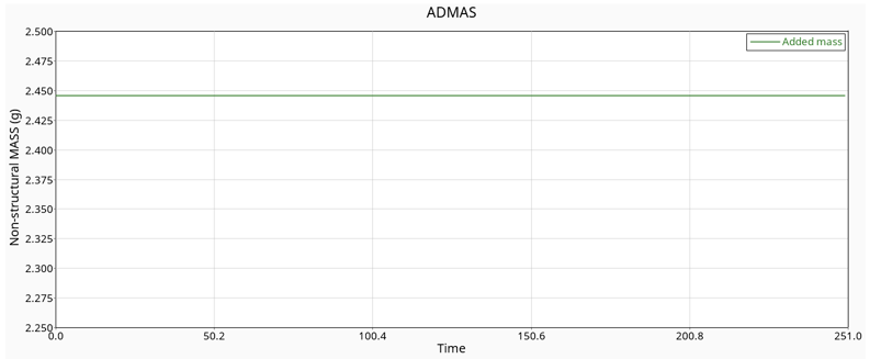

  • /ADMAS/0:
    The mass is added to each node contained in the specified node set. Each node receives 1.68e-3 g of additional mass, and the total added mass is 1.68e-3g x 1453 Nodes, or 2.445g. As expected, the total mass estimated by HyperMesh and the mass calculated by the Radioss solver (in the Starter listing and in the time history) are equal to 435g, as shown here.

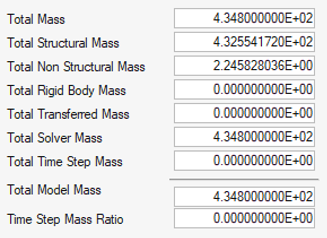

  • /ADMAS/1
    The added mass is divided equally among the nodes in the specified node set.
    Thus, the 2.445 g mass is divided into 1453 nodes. As expected, the total mass estimated by HyperMesh and the mass calculated by the Radioss solver (in the Starter listing and in the time history) are equal to 435g, as shown here.

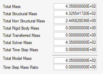

  • /ADMAS/2
    A specified mass of 1.72e-05g is added per unit/area. As expected, the total mass estimated by HyperMesh and the mass calculated by the Radioss solver (in the Starter listing and in the time history) are equal to 435g, as shown here.
