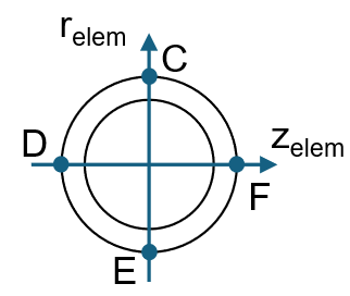

  4. The stress intensification factors, which determine the stresses at the two endpoints of the CBEND elements, are by default at the stress recovery points Ci, Di, Ei, Fi (i = 1,2 corresponding to grid points A and B) of the cross section (Figure 2).
    Figure 2. Default Stress Recovery Points at Cross Section of CBEND Element
