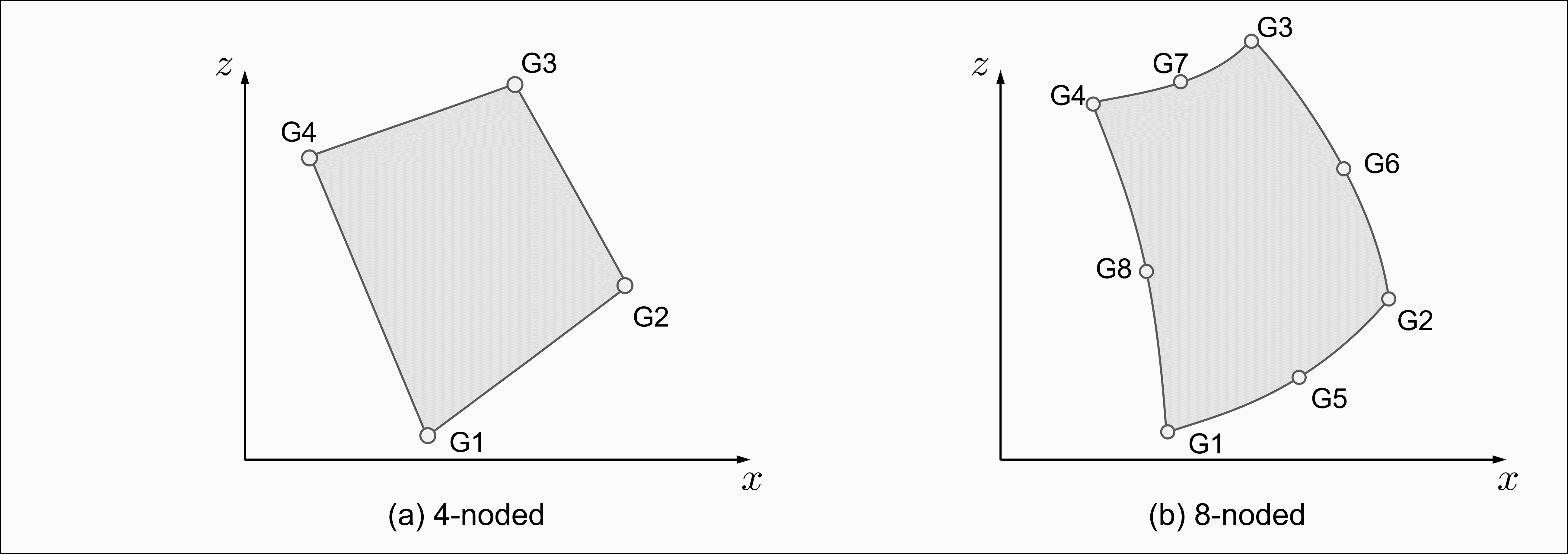

| G1, G2, G3, G4 | Identification numbers
of connected corner grid points. These fields are mandatory. No default (Integers > 0, all unique) |
| G5, G6, G7, G8 | Identification numbers
of connected edge grid points. No default (Integers > 0 or blank) |

- The grid ordering of
G1 through G8 is defined as:
- The continuation is optional.
- The definition of the elemental coordinate system and material orientation angle theta is the same as defined for CQUAD4 and CQUAD8, depending on the number of nodes in the CQPSTS elements.
- Plane stress analysis defined in the x-y plane is supported, that is, the axis labels of “z” can be replaced by “y”. The out-of-plane normal direction defined by the corner node sequence with the right hand rule should point to the z direction if the element is in the x-y plane, or the -y direction if in the x-z plane.
