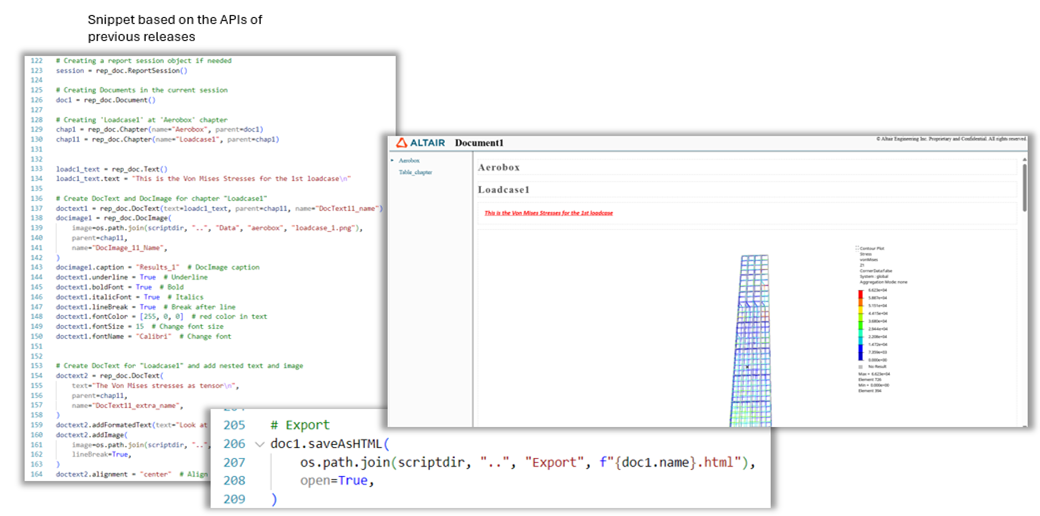

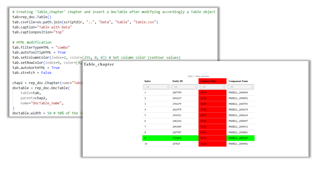

Python API for HTML Export
  • Python API supports HTML export in a self-contained format. This HTML is similar to the HyperView 3D Model export HTML.
  • This includes support for all objects supported in the PPTX and DOCX format reports, including formatting.
  • There are two layout templates that are supported and can be modified.
  • The Table() class objects in HTML support tool tips, sorting and filtering, and row column coloring.
