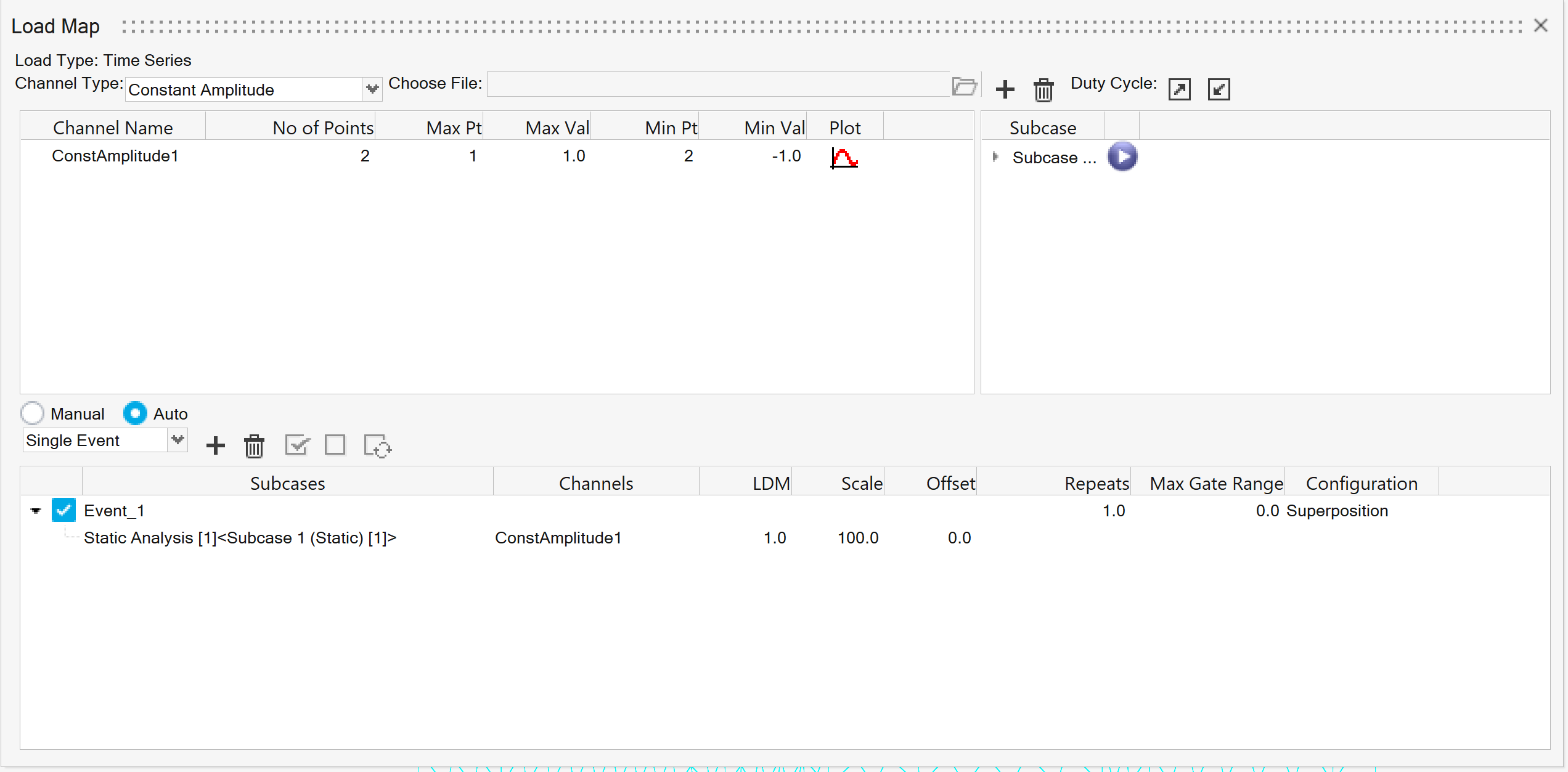

  1. Click the Load Map tool.
    The Load Map dialog opens.
  2. From the Channel Type drop-down menu at the top of the dialog, select Constant Amplitude.
  3. Click to add the load case.

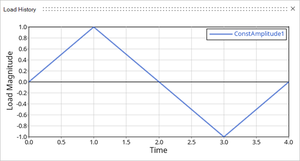

  4. Click to view a plot of the load. Tip: Expand the width of the dialog to view a clearer picture of the plot.
  5. On the bottom half of the dialog, verify Auto is selected for event creation.
  6. Select Subcase 1 and the Constant Amplitude load, then click to create an event.
  7. Event_1 is created with Configuration, select Superposition.
  8. Set Scale to 100.
  9. Activate the Event_1 checkbox.
    Figure 3.
  10. Exit the dialog.
