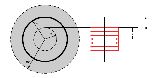

  • Penny Shaped Crack
    Figure 7.

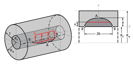

  • External Semi- Elliptical Axial Crack in a Cylinder
    Figure 8.

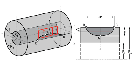

  • Internal Semi- Elliptical Axial Crack in a Cylinder
    Figure 9.

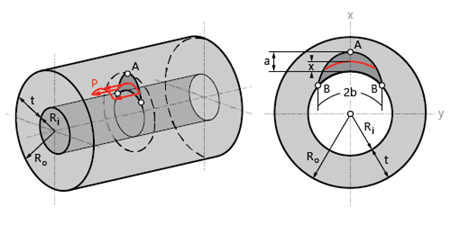

  • Internal Semi- Elliptical Circumferential Crack in a Cylinder
    Figure 10.

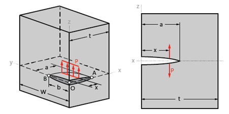

  • Quarter-Elliptical (Out of Plane) + Edge Crack
    Figure 11.

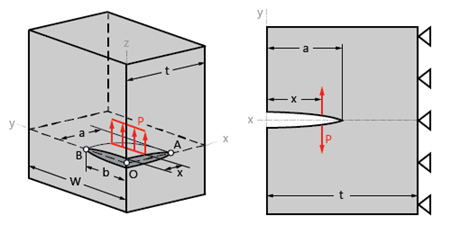

  • Quarter-Elliptical (Out of Plane) + Edge Restrained Crack
    Figure 12.
