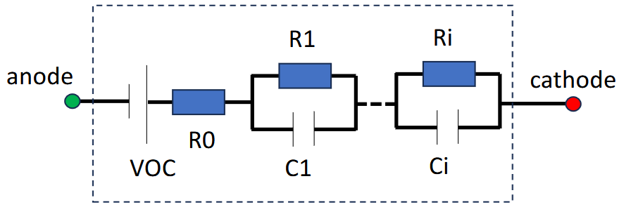

- The circuit of a BCELL element is shown as
below.
Figure 1. Details of a CELL element
