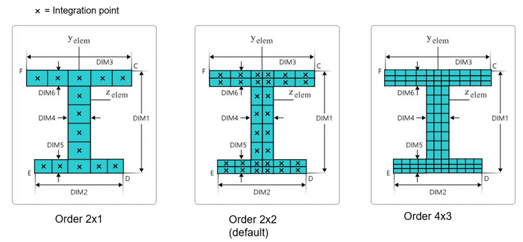

Implicit Analysis: I Section
In implicit analysis, the number of integration point is determined with Q_ORDER and Q_ORDER2. By default it is 2x2, thus 32 integration points.Figure 22. Implicit Analysis I Section Integration Points
