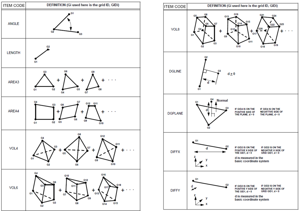

Geometric
A geometric response is a load-independent response that can be selected using RTYPE=GEORESP. These responses are functions of the grid locations specified in the ATTi fields of the DRESP1 entry. There are 19 types of geometric response available, controlled by ATTA. The response types are:
LENGTH
The response is the sum of the distances between consecutive pairs of grids in the ATTi list.
ANGLE
The response is the angle formed between the line defined by the locations of grids GID2 and GID1 and the line defined by the locations of grids GID2 and GID3.
AREA3/AREA4
The response is the sum of areas defined by the grids. The order of the listed grids is important and follows the grid sequence used in first-order shell elements, such as CTRIA3 and QUAD4 elements.
VOL4/VOL5/VOL6/VOL8
The response is the sum of volumes defined by the grids. The order of the listed grids is important and follows the grid sequence used in first-order solid elements, such as TETRA, PYRA, PENTA, and HEXA elements.
DGLINE
The response is the distance between GID3 and the line defined by GID1 and GID2.
DGPLANE
The response is the distance between the location of grid GID4 and the plane defined by the locations of grids GID1, GID2, and GID3. If GID4 lies on the positive side of the plane (determined by the plane's normal vector), the distance is positive. The normal vector is constructed using the locations of grids GID1, GID2, and GID3.
DIFFX/DIFFY/DIFFZ
The response is the difference in the x, y, or z coordinates (respectively) between G2 and G1 in the basic coordinate system. This value can be positive, zero, or negative.
DISTX/DISTY/DISTZ
The response is the absolute difference between the x, y, or z coordinates (respectively) of G2 and G1 in the basic coordinate system. This value can only be positive or zero.
LOCX/LOCY/LOCZ
The response is the x, y, or z coordinate value (respectively) of G1 in the basic coordinate system. This value can be positive, zero, or negative.
