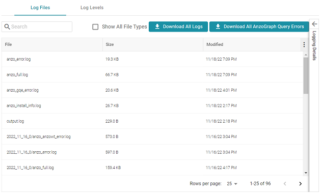

Viewing Logs in the Administration Application
Logs in the <install_path>/Server/logs directory can be viewed and downloaded from the Administration application on the Log Files tab on the Logging screen. The Log Files tab lists the logs that are available to view. For example:
Log Packages that have the Log Level set to Error log events to files with the suffix _error. Operational information that is logged by packages that are set to Info is captured in files with the suffix _info. The current versions the log files are shown at the top of the list. Earlier versions of the logs are prefixed with the name of the <date>_<part> subdirectory they are saved in.

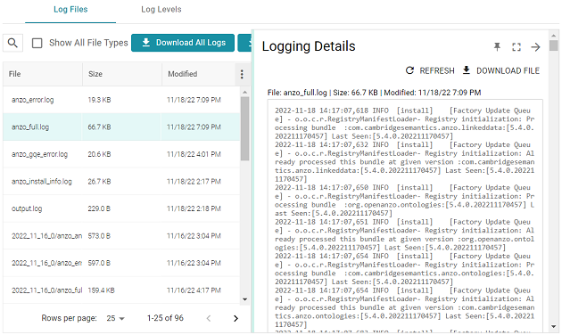

Selecting a log from the list displays its contents in the Logging Details section of the screen. For example:
The following options are available for viewing and downloading log files:
  • To download a .zip file that contains all of the listed logs, click the Download All Logs button at the top of the screen.
  • To download just the query error logs for Graph Lakehouse, click the Download All AnzoGraph Query Errors button at the top of the screen.
  • To re-load the display with the latest version of the selected file, click the Refresh button at the top of the details.
  • To download the file so you can view it in another editor, click Download File at the top of the details.
