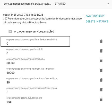

  4. Locate the org.openanzo.ldap.connpool.heartbeatIntervalMillis property (shown in the image below).
  5. Click the property to make it editable. Then replace the current value (0 by default) with the number of milliseconds to set the heartbeat interval. Depending on the network, Altair recommends that you set the interval to between 1 and 5 minutes (60000 to 300000 milliseconds). For example, the image below sets the interval to 3 minutes.
