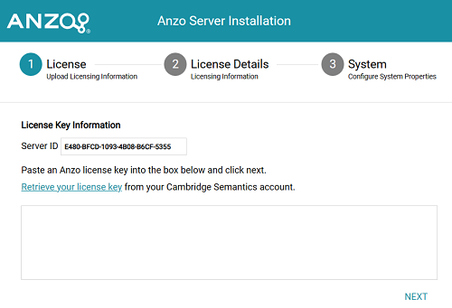

  14. Press Enter to start the Graph Studio services. When prompted, open a browser and go to the following URL to open the initial configuration wizard.
    http://<hostname>:8945/
    Where <hostname> is the host server DNS name or IP address. The License Key Information screen is displayed. For example:
  15. Paste your license key into the box and then click Next. If necessary, you can obtain the license key by clicking Retrieve your license key and logging in to your Altair account.

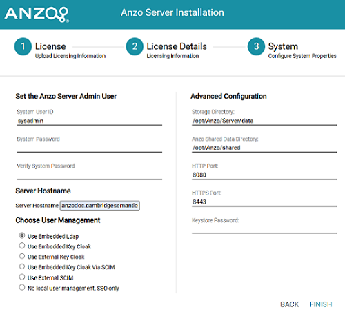

  17. On the left side of the screen in the System Password and Verify System Password fields, specify the password to use for the system administrator, sysadmin.
    Do not change the System User ID. It must be sysadmin. The sysadmin user account has permission to access all features in Graph Studio and Administration applications. In addition, the sysadmin user has read and write access to all of the artifacts (models, graphmarts, datasets, etc.) that are created by all users. For more information about the account, see System Administrator.
  18. Next, review the Server Hostname that is selected for this server. If the field is blank, you can type the name. If multiple DNS entries are defined for the server, clicking the field presents a drop-down list where you can select the name that you want Graph Studio to use. If you plan to use Keycloak and/or set up single sign-on authentication, this is the name that those clients will use to redirect to Graph Studio.
  19. Below the server hostname are the user management options. The options that are displayed depend on whether you installed the embedded LDAP or Keycloak components. The list below describes all options.
    • Use Embedded Ldap:
    • Use Embedded Key Cloak:
    • Use External Key Cloak:
    • Use Embedded Key Cloak via SCIM:
    • Use External SCIM:
    • No local user management, SSO only:
  20. Select the appropriate user management option.
  21. On the right side of the screen under Advanced Configuration, configure the following settings as needed:
    • Storage Directory: This setting configures the location where system data, like the binary store and system journal or volume, is stored. The default location is <install_path>/Server/data. You can specify an alternate location by typing a new path and directory.
    • Anzo Shared Data Directory: This setting specifies the base location of the shared file storage (as described in Platform Shared File Storage Requirements). The default value is /opt/Anzo/shared. Change the default value to the correct location for your shared file system. For example, /opt/anzoshare/data. If the specified location does not exist, Graph Studio will create it. Later you can mount the directory to the specified location or configure another location as a new File Connection (see Connecting to a File Store for information).
    • HTTP Port: This setting specifies the HTTP port for Graph Studio. The default port is 8080.
    • HTTPS Port: This setting specifies the HTTPS port for Graph Studio. The default port is 8443.
    • Keystore Password: This setting specifies the custom password to use for the Graph Studio key and trust stores. The password can be changed in the future. See Regenerate the Server Secret for information.
  22. Click Finish. The wizard configures and restarts the server. The process may take several minutes. Once the server is running, the browser displays the Graph Studio application login screen.
