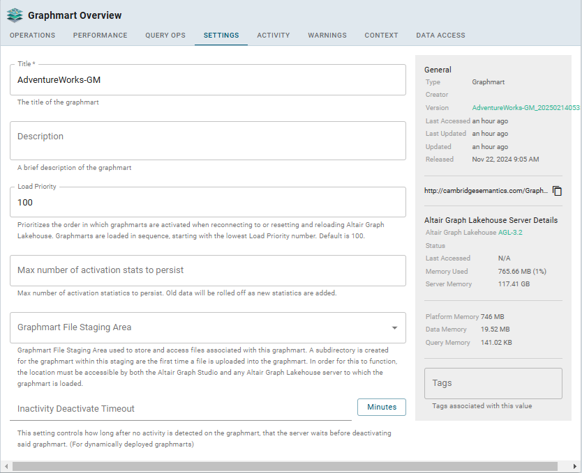

This topic describes the graphmart configuration settings that are available on the Settings tab of Graphmart Overview.
Setting Description
Load Priority If you want Graph Studio to prioritize the order in which graphmarts are activated when reconnecting to Graph Lakehouse or resetting and reloading Graph Lakehouse, you can designate a Load Priority for each graphmart. When reloading Graph Lakehouse, Graph Studio activates the graphmarts in sequence, starting with the lowest Load Priority number. The default value is 100.
