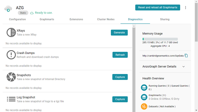

  3. Click the Diagnostics tab. Graph Studio displays the available options. For example:

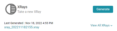

  4. If you want to retrieve an xray, click the Generate button for Xrays. Graph Studio creates the xray and produces a tarball with a .xray extension. For example:
    Click the xray file name to download the tarball to you computer for sending to Altair.
    The files in the tarball are compressed. Do not compress the .xray file before sending it to Altair.
