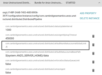

- Locate the com.cambridgesemantics.anzo.unstructured.distributed.defaultNumStatusJournalGlobalLimit property (shown in the image below).
- Click the property to make it editable. Then replace the current value with the maximum number of status journals to keep on disk. The default value is -1 (unlimited). For example, in the image below, the value is set to keep 10 status journals.
