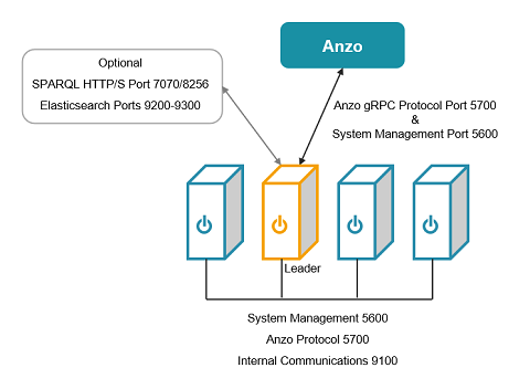

Open the TCP ports listed in the table below. The following image shows a representation of the connections.
When configuring the firewall, keep in mind that Graph Lakehouse also needs to be able to connect directly to data sources if you plan to load data from databases and HTTP endpoints. Database connections are made via JDBC drivers on the Graph Lakehouse file system.
Port Description Required Access
5700 The gRPC port for secure communication between Graph Lakehouse and Graph Studio
The list below describes the access that is needed on port 5700:
  • Between Graph Studio and the Graph Lakehouse leader server
  • Between all Graph Lakehouse servers in the cluster
  • Available to Graph Lakehouse for single node installations
5600 The SSL system management port The list below describes the access that is needed on port 5600:
9100 The internal fabric communications port The list below describes the access that is needed on port 9100:
  • Between all Graph Lakehouse servers in a cluster
  • Available to Graph Lakehouse on single node installations
9200-9300 (optional) If you plan to connect to Elasticsearch, Graph Lakehouse needs access to the Elasticsearch http.port. Between Elasticsearch and the Graph Lakehouse leader server
7070 (optional) Optional SPARQL HTTP port to enable if you want to give external applications access to Graph Lakehouse over HTTP Between client applications and the Graph Lakehouse leader server
8256 (optional) Optional SPARQL HTTPS port to enable if you want to give external applications SSL access to Graph Lakehouse and/or use the command line interface, azgi Between client applications and the Graph Lakehouse leader server
