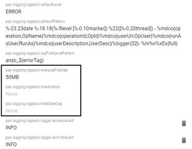

  4. Find the maxLogFileSize, maxHistory, and totalSizeCap properties (shown below).
