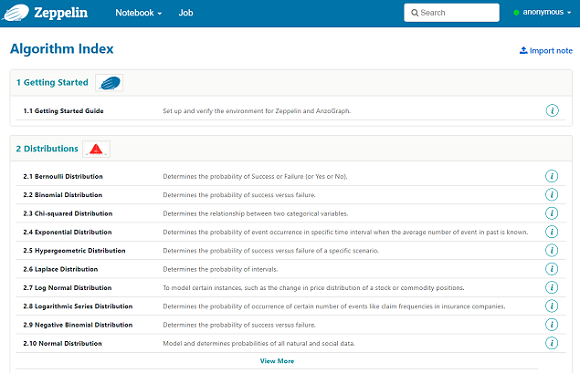

  • If you included the sample notebooks, the Cambridge Semantics index page is displayed, which lists the sample notebooks that are included in the image. For example:
    Each notebook provides details and example usage for one of the Graph Lakehouse Data Science functions. You can click a notebook name to open the file. It might take some time to load all of the contents. To run the queries in a sample notebook or write and run your own queries run against Graph Lakehouse, connect Zeppelin to Graph Lakehouse by following the instructions in Connecting to Graph Lakehouse below. For more information about the data science functions, see Data Science Library. For information about using Zeppelin, see the Zeppelin Documentation.

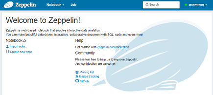

  • If you excluded notebooks, the Zeppelin Welcome page is displayed:
    Connect Zeppelin to your Graph Lakehouse deployment by following the instructions in Connecting to Graph Lakehouse below. If you want to get started with a sample notebook, see Downloading the Tutorial Notebook.

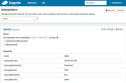

  1. On the top right of the Zeppelin screen, click the anonymous drop-down list and select Interpreter. The Interpreters screen opens.
  2. In the Search interpreters field at the top of the screen, type "sparql" and find the SPARQL interpreter. For example:
  3. Click the edit button and modify the interpreter to enter your Graph Lakehouse deployment details and make a secure connection to the database. The list below describes each interpreter setting:
    • anzo.graph.host: The IP address of the Graph Lakehouse host. If Graph Lakehouse is running in the same Docker instance as Zeppelin, run the following command to return the Graph Lakehouse container IP address:
      docker inspect container_name | grep '"IPAddress"' | head -n 1
      For example:
      docker inspect anzograph | grep '"IPAddress"' | head -n 1
      This command returns the IP address of the Graph Lakehouse Docker container as shown below:
      "IPAddress": "172.17.0.2",
      If you are running Docker locally on a Windows computer, you can run the following command:
      docker inspect anzograph | select-string '"IPAddress"'
    • anzo.graph.password: The password for the user in the anzo.graph.user field. On Docker deployments, specify Passw0rd1.
      RHEL/Rocky Deployments: Use the Admin username and password that was created during the installation.
    • anzo.graph.port: The gRPC port for Graph Lakehouse. The default value is 5700. Do not change this value.
    • anzo.graph.trust.all: Instructs Zeppelin to trust the Graph Lakehouse SSL certificates. Accept the default value of true.
    • anzo.graph.user: The username to use to log in to Graph Lakehouse. On Docker deployments, specify admin.
  4. When you finish adding the connection details, click Save at the bottom of the screen. Zeppelin displays a dialog box that asks if you want to restart the interpreter with the new settings. Click OK to configure the connection.

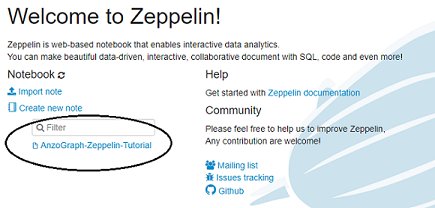

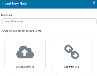

  3. On the Zeppelin Welcome or the Algorithm Index screen if you have the sample notebooks, click Import note. Zeppelin displays the Import New Note screen.
  4. On the import screen, click Select JSON File, and then select the AnzoGraph-Zeppelin-Tutorial.json file to import. Zeppelin imports the note and lists the new file under the filter text box on the home page or in the Notebook menu. For example:
    Click the link to open the notebook. It might take some time to load all of the contents. To run a query in the file, click the run () button for the paragraph. For more information about using Zeppelin, see the Zeppelin Documentation.
