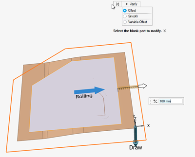

- Select Offset and type a value in the microdialog
to offset the perimeter of the blank by the specified amount.

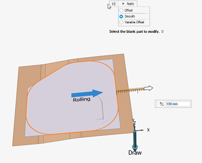

- Select Smooth and type a value in the microdialog
to modify any convex radius larger than the specified value to match the
specified value.

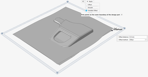

- Select Variable Offset, pick points around the
boundary, and type a distance and offset method in the microdialog to
