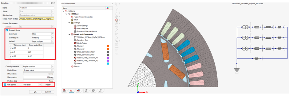

Part1: Transient magnetic analysis
Both the step skewing settings and multi-speed working point settings can be configured when creating a transient magnetic solution.

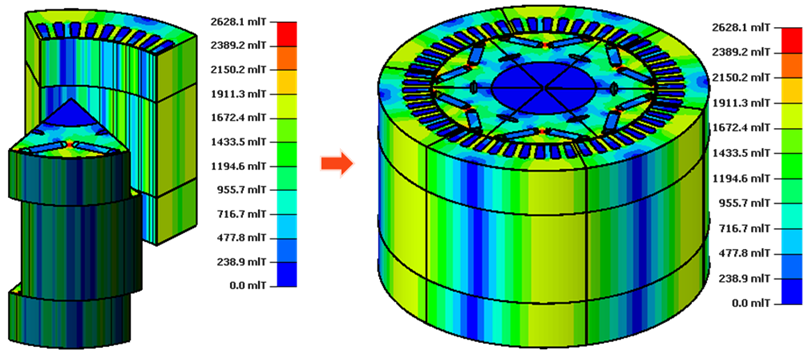

The electromagnetic simulation results (part model view and full model view) are shown as below:

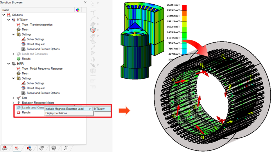

Part 2: Modal frequency analysis
After completing the transient magnetic simulation, the solution coupling in SimLab can be used to realize automatic force mapping from the electromagnetic solution to the NVH solution.

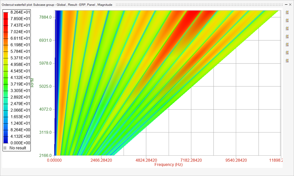

The vibration simulation result (multi-speed waterfall plot) is shown as below:
