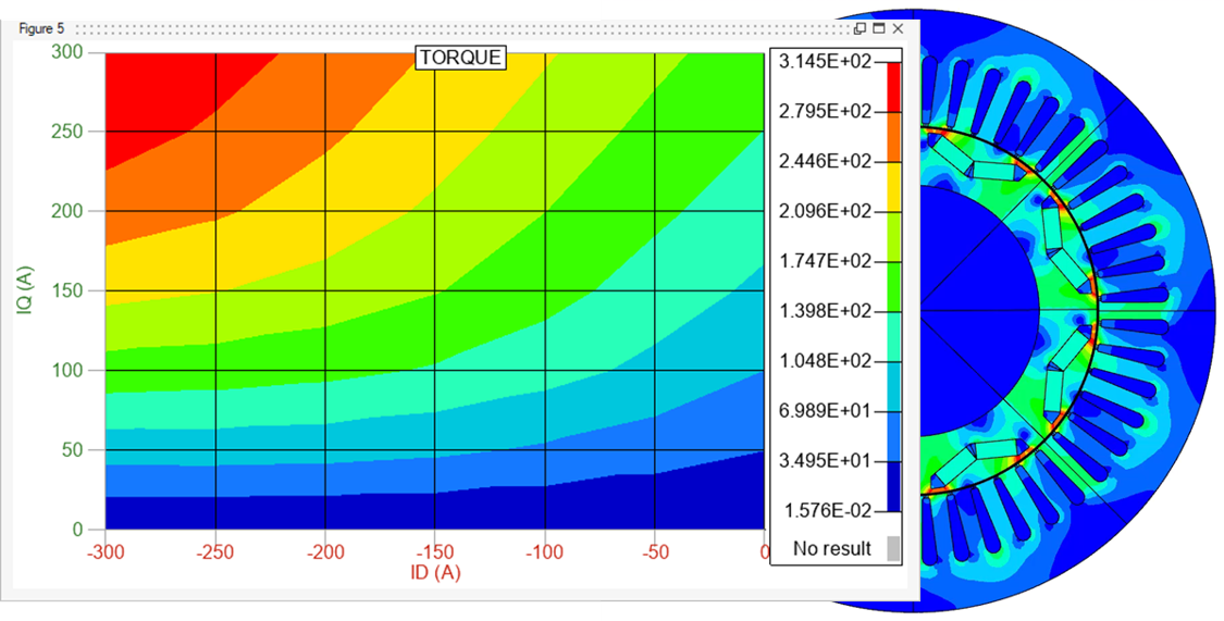

1 Run Reduced Motor Model:
  • Analyze motor characteristics
  • Obtain Look Up Tables
  • Possible for 2D or Skew model

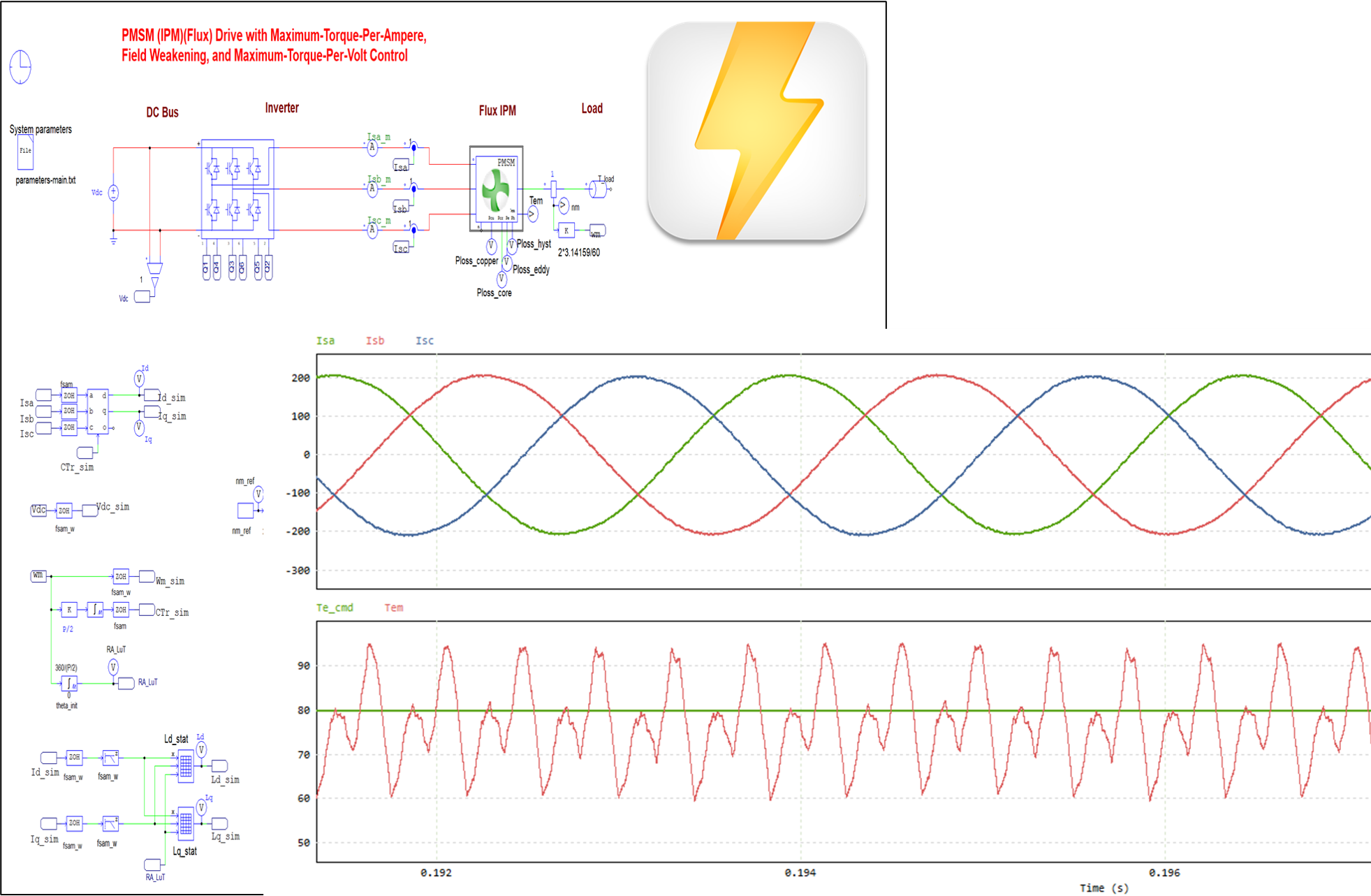

2 Import in PSIM:
  • Use dedicated Flux coupling in PSIM to import the model
  • Run system analysis of the model to get true PWM waveforms

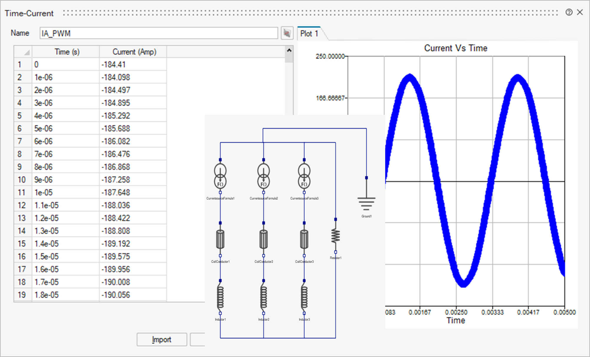

3 In SimLab import waveforms to MT2D:
Easily import the inputs waveforms from PSIM in SimLab

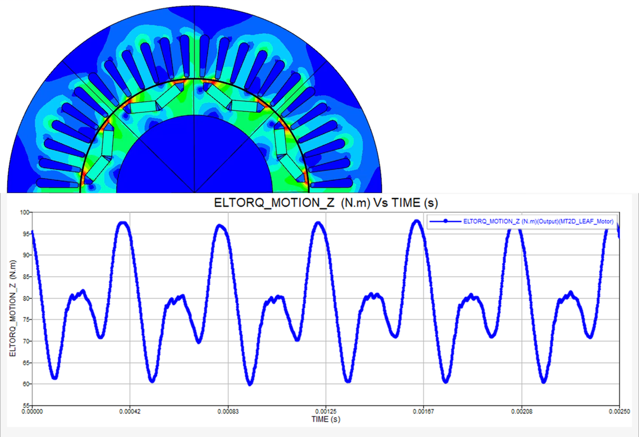

4 Emag performance (MT2D):
Setup the transient simulations to check the influence of the actual waveforms on motor Emag performance

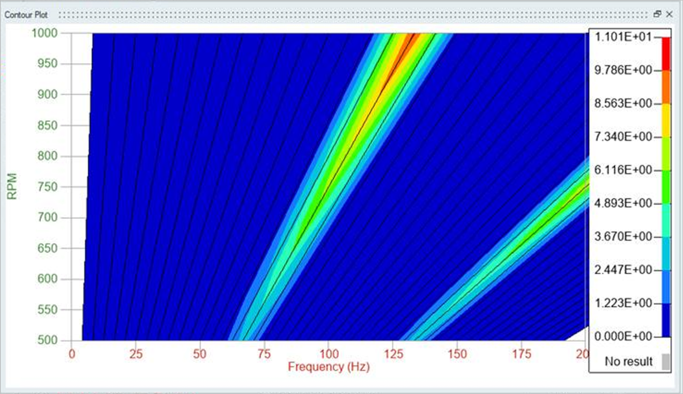

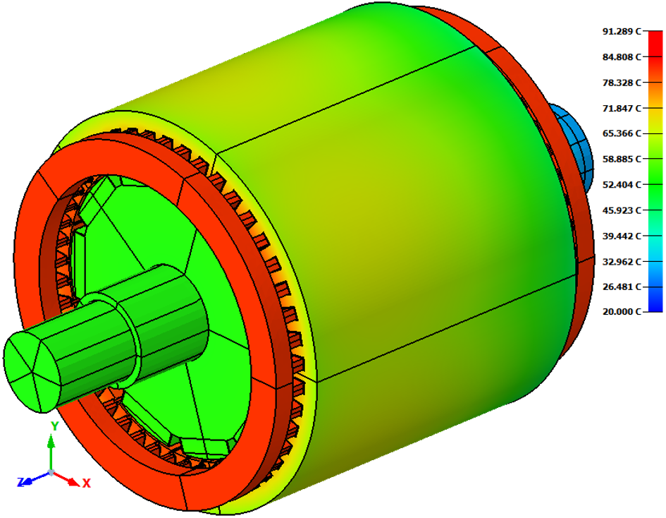

5 NVH and Thermal analysis:
Couple the transient analysis with NVH or CFD/Thermal analysis to check the influence of system of motor performance.
