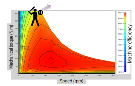

When analyzing PM motors, we often compute efficiency map (see Figure below). We propose here to focus on the base point and check how we can improve it: maximize mechanical power available and minimizing mass of magnets. The mass of magnets is also dealing with cost of motor as the magnet is usually quite expansive compared to other elements of the motor. Decreasing mass of magnets also allows going toward a more sustainable world, decreasing the footprint of human activities.

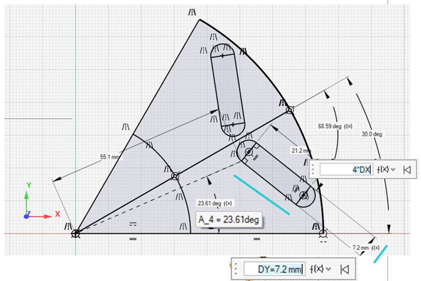

We propose to fix max current and use the speed and the control angle as physical parameters. As regards magnets, a set of parameters will allow modification of magnet shape in the rotor part (see screen shot below).
We have dedicated parameters to define shape of the magnet:
  • DX : width of the magnet (DX=5.3mm and 4*DX=21.2mm)
  • DY : length of the magnet (DY=7.2mm)
  • R_4 : radius of one corner of the magnet (R_4=55.1mm)
  • A_4 : angle of one corner of the magnet (A_4=23.61 degree)
  • A_1 : angle of the magnet (A_1=68.59 degree)

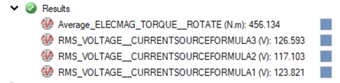

It is also possible to define results which will be used by the optimizer as results.

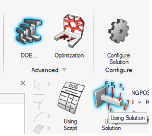

Once the project has been defined with all geometric and physical parameters, there is a one click button to open Altair HyperStudy the Altair optimizing tool.
All input parameters and output results are already transferred to the optimizing tool.
