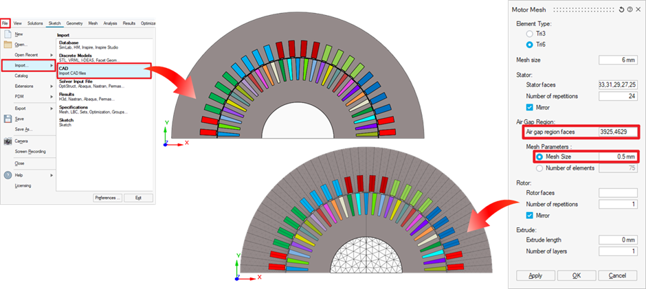

Geometry import and meshing
After importing the provided motor 2D CAD file (*.xmt_txt format), SimLab's Motor Mesh tool can easily generate a symmetrical mesh suitable for the 2D motor analysis.

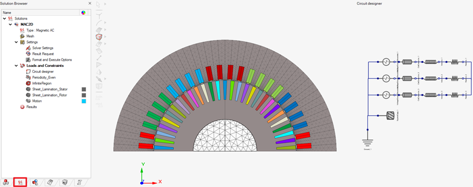

As shown in the figure below, after setting up all the required LBCs and the coupling circuit, the configuration of basic steady-state solution is completed.

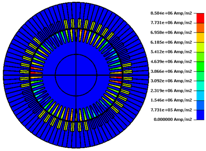

The full model result view is shown below:

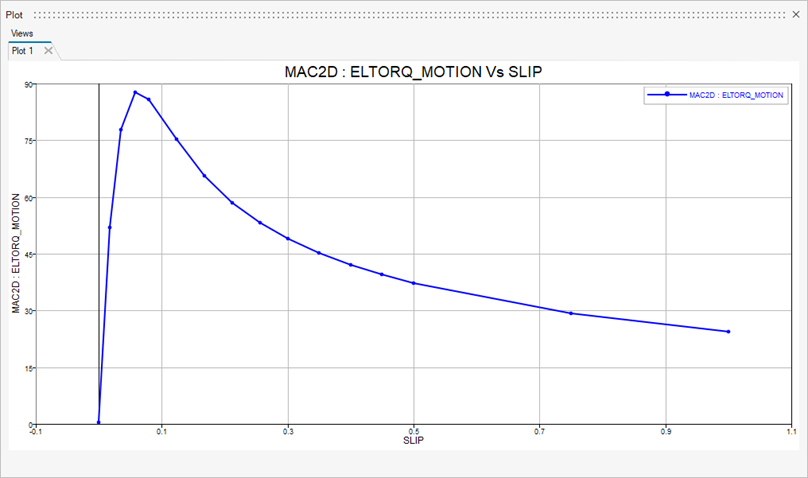

Study 2: Torque-speed characteristic

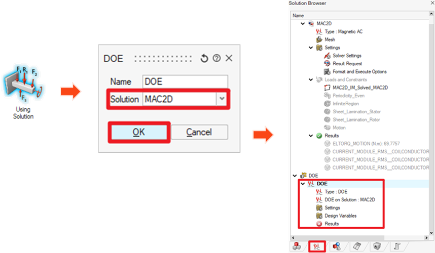

The previous basic steady-state solution can be further connected with a DoE solution in SimLab to run parameter sweeps.
The Torque v.s. SLIP curve can be obtained after setting the scanning parameter to SLIP.

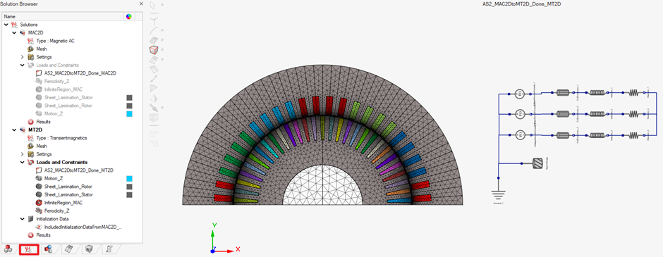

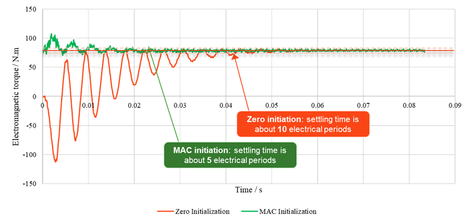

The last study is a transient simulation for rated load, initialized from a previous steady state study. In SimLab, the initialization is realized by the solution coupling technique, as shown below:
Initializing from the steady state results can reduce the setting time compared to initializing from zero, effectively reducing simulation time.
