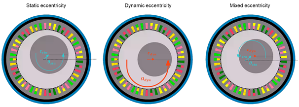

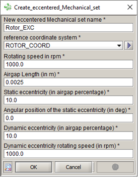

CreateEccenteredMechanicalSet.PFM (New)
Create a mechanical set which defines an eccentered rotor for your electrical motor. You can define any type of eccentricity (static, dynamic or mixed) depending of the inputs of the macro.

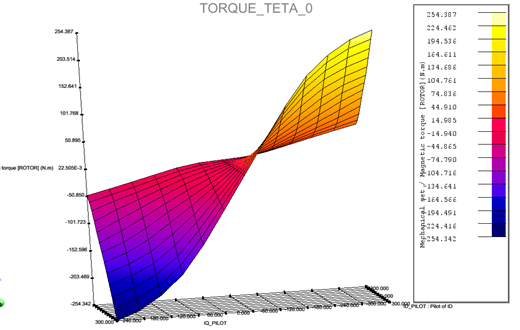

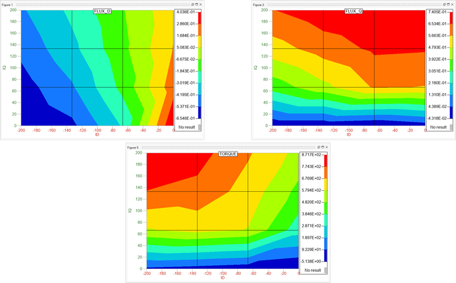

CreateLookUpTableFromTMProjectDQLight.PFM (Update)
Macro now consider any type of formulation (float, mathematic formula, parameter name) of the end winding inductance, especially the one given in a project generated with FluxMotor.
CreateLookUpTableFromTMProjectDQLight3D.PFM & CreateLookUpTableFromTMProjectDQLightSkew.PFM (New)
Adaptation of the CreateLookUpTableFromTMProjectDQLight macro for 3D and Skew projects.

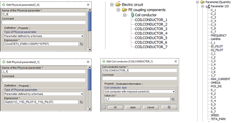

A faire : Those macros create look up table of φDQ, LD, LQ and torque versus ID, IQ and rotor position. It will create a new Magneto-Static project from the magnetic transient one. In the Magneto-Static project the current is driven with ID and IQ allowing to extract easily all the needed tables. At the end of the oml file in comment there is the possibility to display Ld, Lq and torque versus Id and Iq with Altair Compose.

  • CreateLookUpTableFromTMProjectDQ_nphases.PFM
    Adaptation of the CreateLookUpTableFromTMProjectDQLight macro for supporting any number of phase. CreateLookUpTableFromTMProjectDQ_nphases runs CreatePark_Iabc_Drivenby_Idq_nphases and CreatePark_dq_From_abc_nphases to compute look-up tables of n-phases emotor models.
  • CreatePark_Iabc_DrivenbyIdq_nphases.PFM
    Create IA,B,C,... driven by IDQ and a parametric scenario to compute directly φD, φQ and torque versus ID and IQ.
  • CreatePark_dq_From_abc_nphases.PFM
    Create DQ parameters from A,B,C, … components using the Park transformation. Here, it computes φD and φQ from φA, φB, φC, ...
