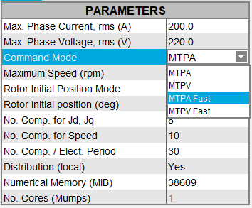

A new solving workflow for the MTPA and MTPV command modes has been implemented.
As a result, there are two new command modes:
  • MTPA Fast
  • MTPV Fast
Remarque : For these two new command modes MTPA Fast and MTPV Fast:
  • The parametric solving process is done only on the parameters Jd and Jq.
  • It is not possible to modify the Number of Computations for Speed, nor the Number of Computations per Electrical Period. These two fields are disabled (grayed out).
With this new fast solving workflow (MTPA Fast and MTPV Fast command modes), the computation is faster than with the standard solving workflow (MTPA and MTPV command modes).

Post-process with a new command
As you are used to, it is possible to post-process a new test from a previously solved test, just by modifying the command inputs:
  • Max. Phase Current, rms (A)
  • Max. Phase Voltage, rms (V)
  • Command Mode MTPA/MTPV or MTPA Fast/MTPV Fast
Avertissement : It is possible to modify the command mode but using the same solving workflow only.
  • If you use the new fast solving workflow, it is possible to switch:
    • from MTPA Fast to MTPV Fast
    • from MTPV Fast to MTPA Fast
  • If you use the standard solving workflow, it is possible to switch:
    • from MTPA to MTPV
    • from MTPV to MTPA
