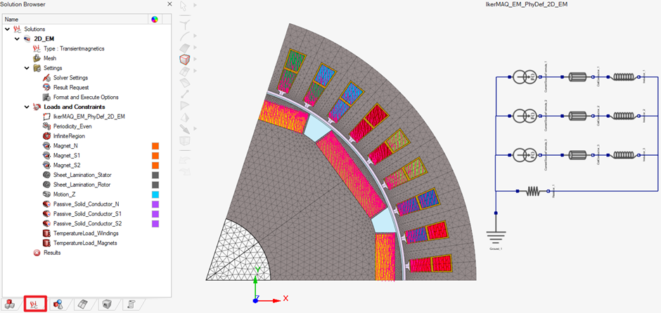

Part 1: 2D transient magnetic solution setup
This part does not need to be solved. It only needs to configure a 2D transient magnetic solution (including various LBCs and coupling circuits), as shown below:

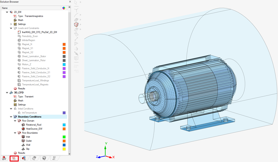

Part 2: 3D transient flow solution setup
This part also does not need to be solved. It only needs to configure a 3D transient flow solution (including various LBCs), as shown below:

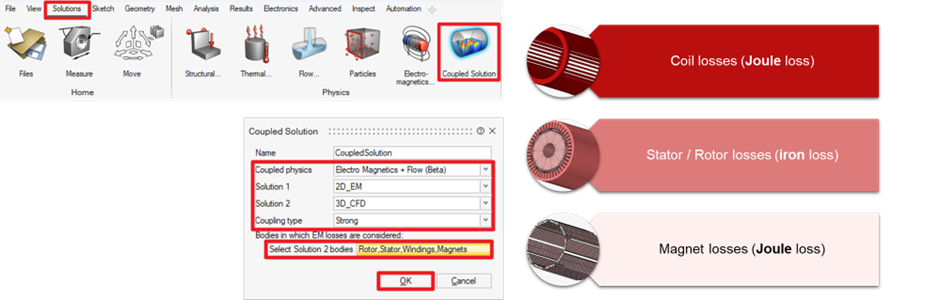

Part 3: EM-CFD 2-way coupling solution setup and solving
After setting up both the 2D EM and 3D CFD solutions, the coupled solution can be used to couple the two solutions bidirectionally and solve it.

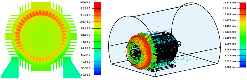

The air-cooling results (temperature distribution and air speed) are shown as below:
