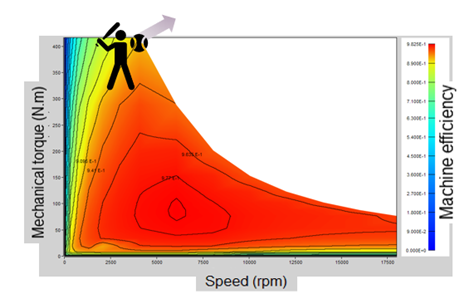

When analyzing PM motors, we often compute efficiency map (see Figure below). We propose here to focus on the base point and check how we can improve it: maximize mechanical power available and minimizing mass of magnets. The mass of magnets is also dealing with cost of motor as the magnet is usually quite expansive compared to other elements of the motor. Decreasing mass of magnets also allows going toward a more sustainable world, decreasing the footprint of human activities.

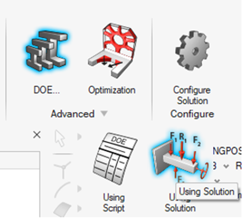

Once the project has been defined with all geometric and physical parameters, there is a one click button to open Altair HyperStudy the Altair optimizing tool.
All input parameters and output results are already transferred to the optimizing tool.
You can select which parameters you want to keep and also define the ranging values.
You can also add the output you want to focus on: here output power and cross section of magnet.
You can create DOE, fit function, optimize on fi functions and then recompute the Pareto plot with initial SimLab solver. You can see on the screenshot below that the difference between fit functions and real functions is less than 5%.
