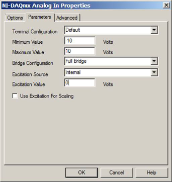

Creates channel(s) to measure voltage with excitation to scale the measurement.
Additional Information: Refer to the National Instruments NI-DAQmx C documentation.
Bridge Configuration: Indicates the type of Wheatstone bridge.
Excitation Source: Indicates the source of the excitation.
Excitation Value: Indicates the amount of excitation, in amperes, that the sensor requires.
Maximum Value: Indicates the maximum value you expect to measure.
Minimum Value: Indicates the minimum value you expect to measure.
Terminal Configuration: Indicates the input terminal to be configured for the channel.
Use Excitation for Scaling: Specifies whether the measurement is divided by the excitation.
