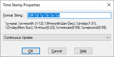

Format String: Specifies the format for displaying the date and time.
Update Frequency: Specifies when the time stamp is applied.

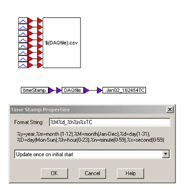

If you want to log data acquisition results in a file where the file name is tied to the date, you can use the timeStamp block in conjunction with the export block, as shown below:
timeStamp ex
Here the variable DAQfile expands to Jan02_162454TC, resulting in the complete file name Jan02_162454TC.csv.
