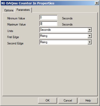

Creates a channel to measure the amount of time between rising or falling edges of one digital signal.
Additional Information: Refer to the National Instruments NI-DAQmx C documentation.
First Edge: Specifies on which edge of the first signal to start each measurement.
Maximum Value: Indicates the maximum value you expect to measure.
Minimum Value: Indicates the minimum value you expect to measure.
Second Edge: Specifies on which edge of the first signal to stop each measurement.
Units: Indicates units to use to return the measurement.
