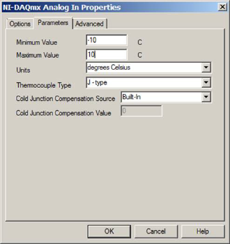

Creates channel(s) that use a thermocouple to measure temperature.
Additional Information: Refer to the National Instruments NI-DAQmx C documentation.
Cold Junction Compensation Source: Indicates the source of cold junction compensation.
Cold Junction Compensation Value: Indicates the temperature of the cold junction of the thermocouple to which you set the CJC source.
Maximum Value: Indicates the maximum value you expect to measure.
Minimum Value: Indicates the minimum value you expect to measure.
Thermocouple Type: Indicates the type of thermocouple connected to the channel.
Units: Indicates the units to use to return the measurement.
