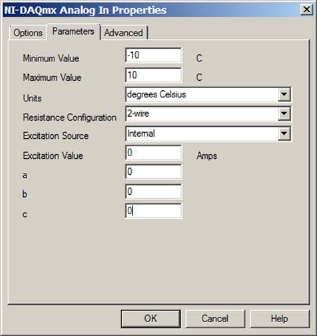

Creates channel(s) that use a thermistor to measure temperature when the thermistor requires current excitation.
Additional Information: Refer to the National Instruments NI-DAQmx C documentation.
a: Indicates the A constant from the Steinhart-Hart-thermistor equation.
b: Indicates the B constant from the Steinhart-Hart-thermistor equation.
c: Indicates the C constant from the Steinhart-Hart-thermistor equation.
Excitation Source: Indicates the source of the excitation.
Excitation Value: Indicates the amount of excitation, in amperes, that the sensor requires.
Maximum Value: Indicates the maximum value you expect to measure.
Minimum Value:
Resistance Configuration: Indicates the configuration for resistance measurements.
Units: Indicates the units to use to return the measurement.
