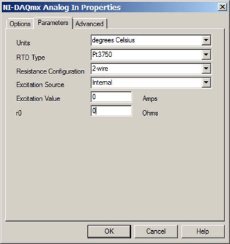

Creates channel(s) that use RTD to measure temperature.
Additional Information: Refer to the National Instruments NI-DAQmx C documentation.
Excitation Source: Indicates the source of the excitation.
Excitation Value: Indicates the amount of excitation, in amperes, that the sensor requires.
r0: Indicates the sensor resistance in ohms at 0o C for the Callendar-Van Dusen equation.
Resistance Configuration: Indicates the configuration for resistance measurements.
RTD Type: Indicates the type of RTD connected to the channel.
Units: Indicates the units to be used to return the measurement.
